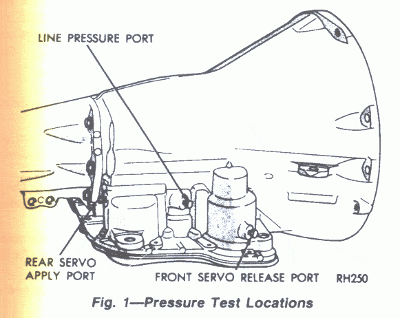

Is there anything else I should check before pulling the pan? I see that you can test line pressure at various spots externally, would there be a point to that?

Yes you can check line pressure at the port on the passenger side. Warm it up first. Hook up your gauge, put the ebrake on and block the wheels. Should be at least 60 at idle in D/2/1, and go up at around 95 when you push the kick down all the way back.

Monday & Tuesday I checked the pressure at the Line Pressure & Rear Servo ports.
LINE PRESSURE PORT
Cold start, high idle cam engaged, idling for less than 2 min. No kickdown
D/2/1 pressure 68-73 psi Slight whine
N/R/P pressure 0 psi Louder whine in R, quiet in N & P
Regular Idle, engine has been running about 6 min. No Kickdown
D/2/1 pressure 45-65 (mostly 55-65) Very slight whine
N/R/P pressure 0 Maybe some whine in R, quiet in N & P
Regular Idle, engine has been running about 11 min. Full Kickdown
D/2/1 pressure 8-9 psi
N/R/P pressure 0
Regular Idle, engine has been running about 15 min. No Kickdown
D/2/1 pressure 6-7 psi
N/R/P pressure 0
REAR SERVO PORT
Basically 0 psi – slight twitch in R & 1 (maybe 1-2 psi)
High Idle, engine has been running about 6 min. Full Kickdown
Regular Idle, engine has been running about 13 min. No Kickdown
0 psi in any gear
So it seems like maybe there are 2 separate things going on.
From a cold start, the forward gears are pretty normal, but after 10 min of idling it loses pressure and stops working.
Reverse isn't getting any significant pressure at all.
