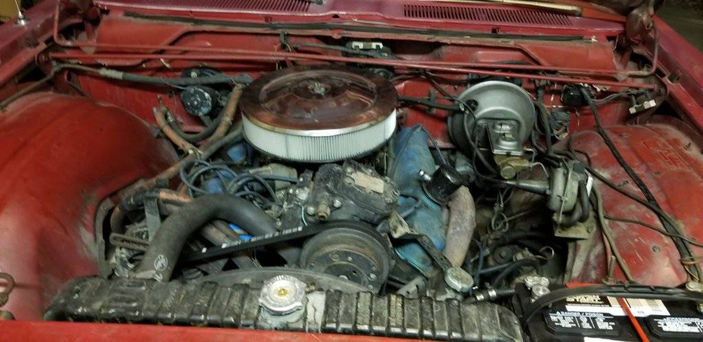

Have a 68 Chrysler newport convertible. 383 with factory 4 barrel and dual exhaust. It starts and generally drives fine but the carb does Need to be rebuilt. I also have a leak in the intake manifold gasket. It's just a cruiser car but I do love power. I don't intend to go crazy on the engine for now but debating on if I should just replace the gasket and rebuild the carb or of I should get an edelbrock intake and 750 carb and just redo that whole top area. The car did have some work done a while back from previous owner and had a mild cam upgrade done.also I have factory ac which I heard could cause bracket mounting issues with a replacement manifold having the choke relocated from factory Peyton

The person I bought it from bought it used in 1972. They've had it since so I'm only the third person to own it. It was the guys mom's car who died a couple years back and he doesn't drive it much anymore and was time to let it go. He told me she had done engine work done years back but didn't know the details, just that it had a slightly bigger cam. It does have a Carter 4 barrel. The ac is disconnected but still there. Has a few leaks I'm dealing with underneath. It starts great, runs decent enough but I can't floor it from a stop without the engine wanting to hesitate and potentially die but if I do it right after I get moving I can floor it just fine with no problems. It's mostly just a weekend cruiser but I want a smooth experience and I think it's just the carb needing to be rebuilt. I figure for not too much more money if I'm taking the manifold off anyways maybe just do an upgrade. If there is good opinions about the stock manifold I don't mind keeping it, but I don't mind swapping it out either if it's worth it

Ok guys. I think I'm sold on keeping it stock and rebuilding the carb. I think if I want to go a more horsepower route in the future I might just buy a stand and a block and make a little hobby of building something legit. I appreciate the input.
