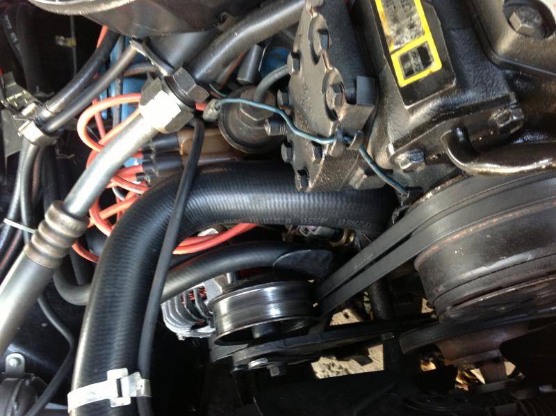

Finally, for you 400/440 fans... The length of the belts between the alternator and the compressor is so long that they vibrate like hell at idle... Especially when it's hot outside and the system is under stress. Later model C Bodies had an idler pulley mounted in between which eliminates this annoying vibration completely.
I managed to adapt one out of a 93 Lincoln with a 5.0 that works great and bolts in with a little modification.
Here it is:
