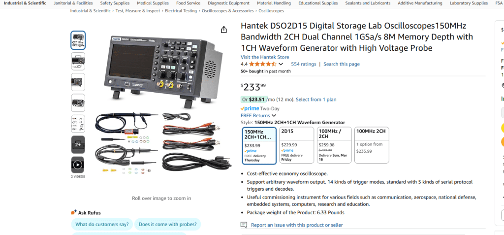

Thanks for the educational answer. I will have to take a closer look into your brand selections. Just doing a basic search and knowing that that once I get these fixed, my use will be limited (unless I go down a rabbit hole with different types of projects). As of yesterday I was looking at something like this which is more than I will likely need.

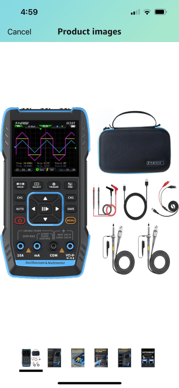

I think a scope is useless without a dedicated trigger input, many hand-held scopes don't have trig in, like the one you show. If your anticipated ergonomics will lend itself to a benchtop scope, I would choose the Hantek DSO2D15 ($232 on Amazon).

In my writing, I was only considering bench top scopes, possibly some being portable, but not handhelds. Early handhelds were quite limited. I looked at the one you mentioned. The specifications look decent and likely will fit the bill for your engine analyzer work. The combined multimeter and signal generator could prove handy. I am not a fan of all-in-one devices on the bench (although they can be okay depending on the situation), but they can be useful in remote or field work. The mentioned lack of external triggering can be an issue, but one channel should be able to trigger from the other if the scope has that ability. The color screen looks nice and helps in separating items on the small screen. The picture shows it comes with probes and leads. The probes are listed as P6100 (which has become a generic number adaptation of old Tektronix numbering) which generally are specified at 100MHz. It mentions temperature, but I don't see a thermocouple or similar adapter device. I'm not familiar with the brand, but there are a multitude of small companies, particularly Asian, making equipment like this. The price is not bad.
I did a little more looking. This handheld one does have a trigger. May still look around a bit, but likely plenty of features and power for my 1975 circuit board.
Yes, they can trigger on your A or B (channel 1 or 2) input, but they don't have a dedicated trigger input.
Lots of times in electronics you have a signal that you want to use as a sweep trigger but you don't need or want to actually see that signal.
Ok going in a little hotter than planned. About double of what I wanted to spend, now I will have to discover the mysteries of small Cricut boards. Looks like a decent value for the features and give me plenty to learn about in retirement.

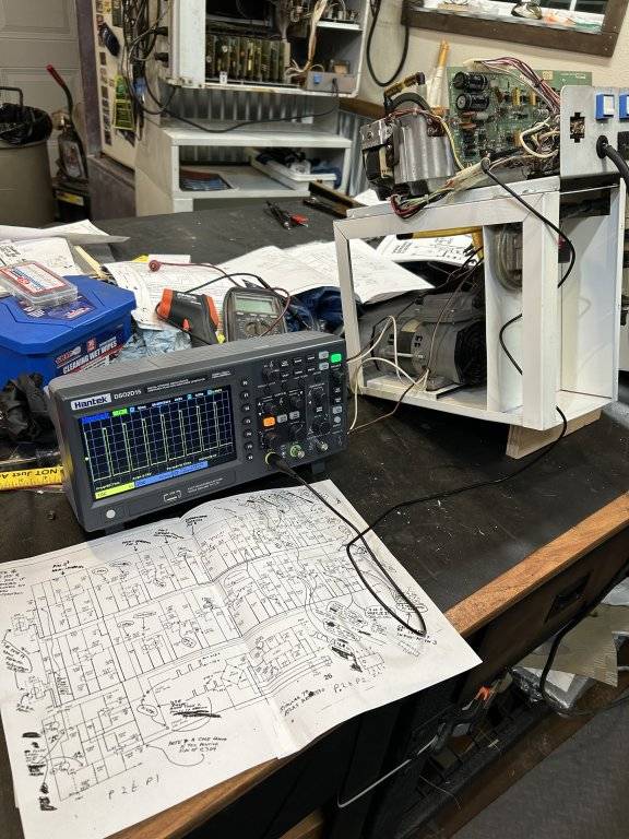

Uh. I thought the handheld was over $300. I see now that it was $100. The individual control knobs for the various functions is well worth it compared to the hand-held.
I got it, read the manual, watched a few videos and got to work. For a minute I struggled as the first point I tested doesn’t seem to be right. Then I tried couple other test points and found that the auto set worked great. I will post some of my questions and test results in my analyzer rebuild thread. I want to get deeper into the schematic and may have some questions.
