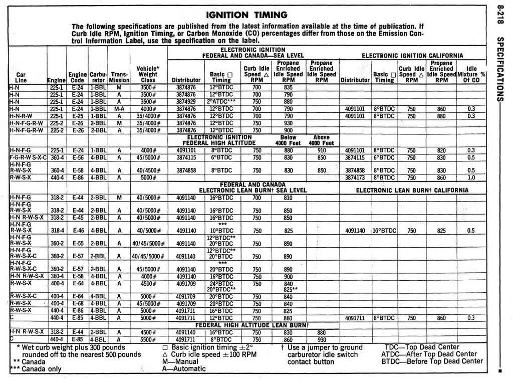

Also, Sniper manual calls for 15 degrees BTDC when setting the distributor, but if I read the specs on the Canadian 400 big block correctly, it should be 20 degrees for the basic setup. I plan to call Holley tech support with this, but some second opinions are very much welcome as well.

And if the sniper asks for 15°, and Chrysler asks for 20°, start at 17°-18°, and tune from there. A few degrees isn't going to hurt anything.

The orig ELB timing was "base + computer". Are you setting the Sniper to do similar? Key thing is that it starts easily and quickly. Might start with 15 degrees and see how it runs. Increase a bit to see how it acts and runs. If no "spark clatter" on acceleration, whatever works. If the system uses a Knock sensor, might edge up to 20 and see how it goes.
No knock sensor there.
I hope I interpret this thing correctly (Canadian 400 C-Body, Line 6 counting from bottom up):
