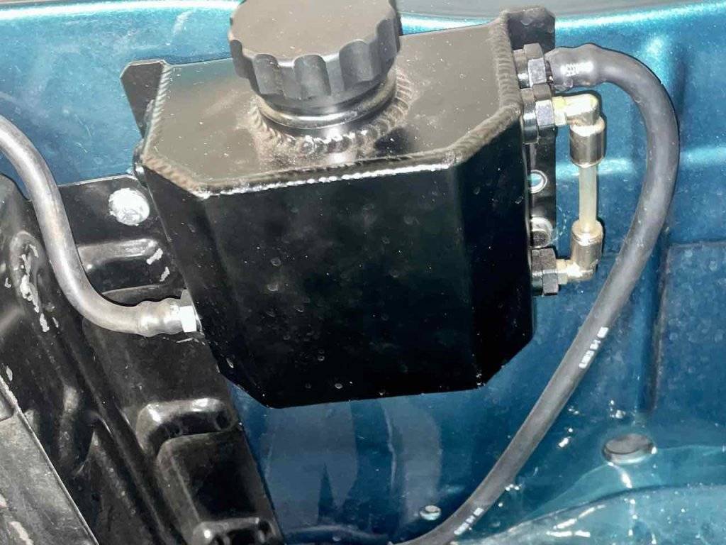

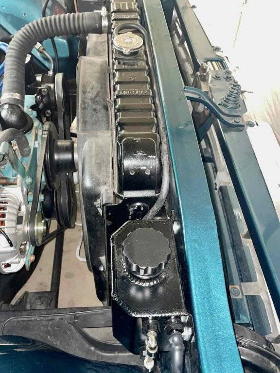

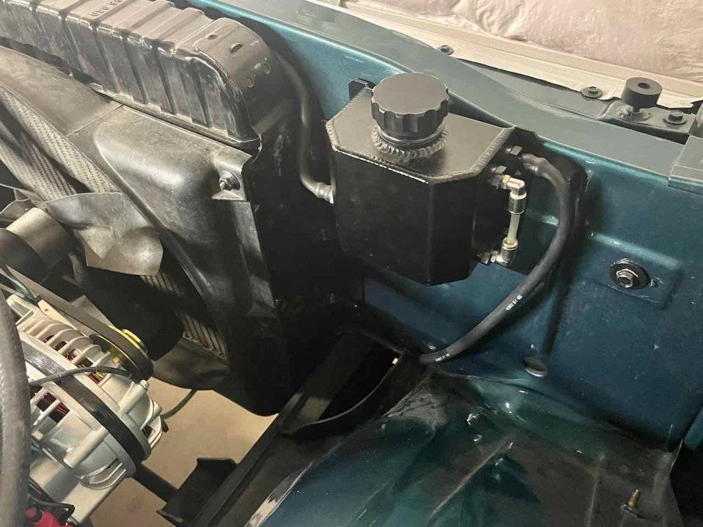

I've been upgrading several of my rigs to fit a Dorman 54002 USA made recovery kit, finally now settling on a spot that involves factory horn placement removal but it's worth it.
Bought this one and mounted next to the radiator on the passenger side of the vehicle, works great and looks clean. I can send pics later when back home if interested.
Mishimoto MMRT-1LBK Mishimoto Universal Coolant Overflow Tanks | Summit Racing
everything I read said to mount the top at the same level as the radiator if you want it to actually function like new cars where it will siphon back and forth with the radiator as the cooling system pressurizes. This one has worked out great and just like I described but I had to sand down the cap top and paint it, couldn't have anything that said mishimoto visible as soon as you pop the hood!lol

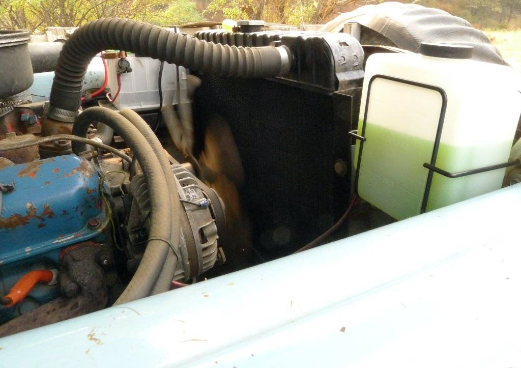

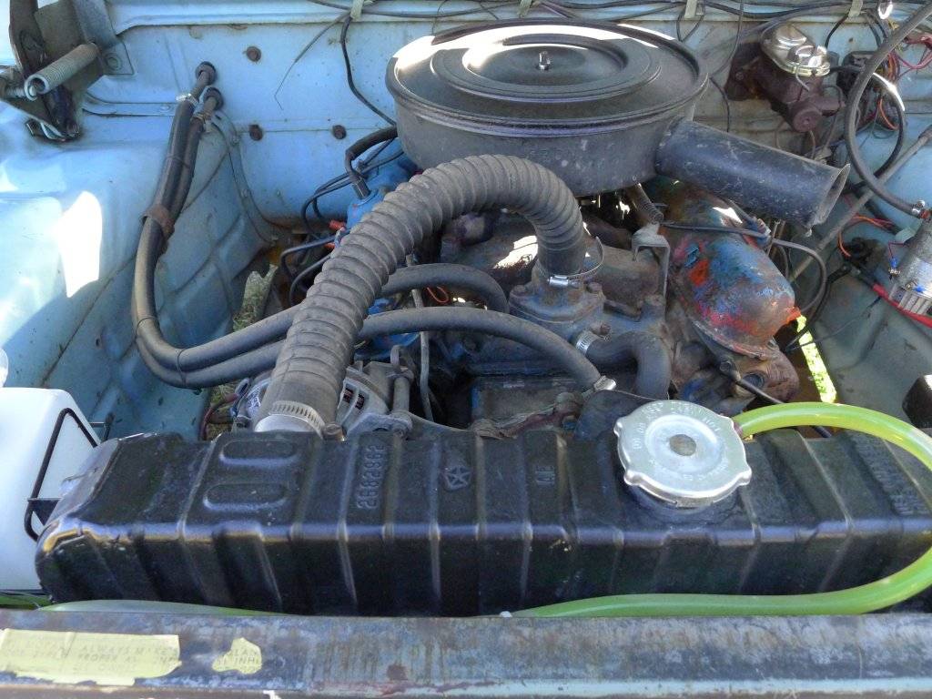

When I added an aftermarket coolant recovery jug to our then-recently new 1969 Chevy pickup, I used the mounting place of the windshield washer reservoir, so no holes to drill. Then I somewhat expected the clear line going to it from the radiator to remain full of fluid, which it did not or would not. No matter how many times I purged it of air. The radiator stayed full, but the coolant recovery jug, which also had coolant in it, sometimes did not change levels, hot or cold.
I also somewhat expected the pickup to run cooler, as the top 15% or so of the crossflow radiator core was now full. But it made no significant difference. BTAIM
I fully concur with the benefits of an "always full" radiator are supposed to be. In the earlier days, there were differences in normal radiator caps and coolant recovery radiator caps, but as things seemed to have evolved, everything now is "coolant recovery" caps. Initially, they were completely round, no "ears".

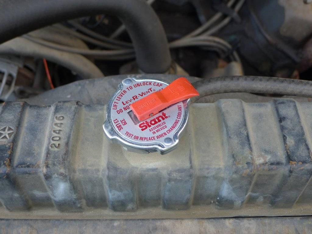

You should definitely change cap to one that doesn't invite opening such a Lever-Vent.
I personally stay away from higher pressure caps, prefer 13bs.

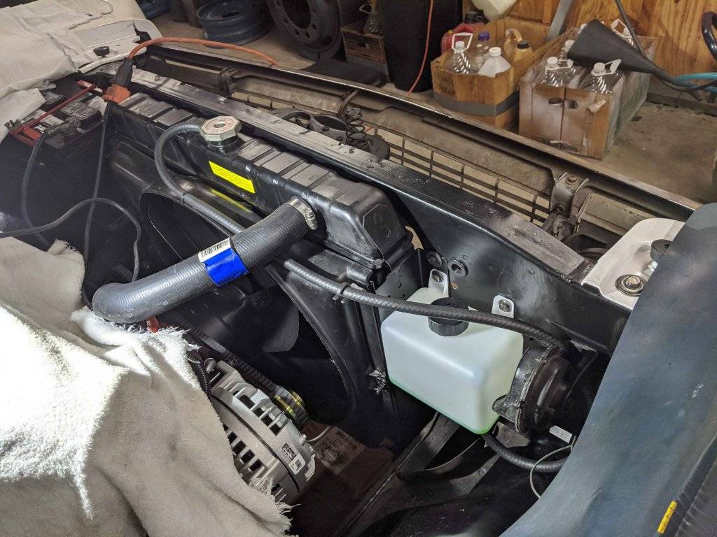

Before tank install, 1970 383.
Post tank install, '69 318.
Waiting on my formed hoses, or the 2nd one now. Tough to find the right hoses, the last set I ordered were totally wrong so I still have these junkers on there and they really bother me, the top one is cracking.
Rad is from a '66 Monaco/Newport etc w/383 & AC, but has Dodge truck ears, I had it custom made from 2 radiators.
I'm was very lucky to finally get a radiator in it, nearly a 2 year search.
Stupidly, I tried to sell this radiator for a year after I had it rebuilt and found out it didn't fit. Had it been a B body rad, it would have sold in minutes, but been a C body rad, nobody wanted it, lucky me.
One day I realized I had a totally wasted big block truck rad that had the right ears and went and had them put on. The solution was staring at me in the face but I'd never realized it.
The truck had been without a rad for a whole year at this point, I was starting to despair at ever finding a proper rad for it.
I like the look of your radiator coolant reservoir.
I disagree with "level with top tank"
I have had 3 fuselage c-bodies where I installed reservoir below the top tank and the system worked perfectly.
Remember, coolant flows into the overflow tank when the cap on the radiator opens, due to pressure. Similarly, the radiator siphons coolant from the overflow tank when there’s a lower pressure in the radiator, after overcoming the seal resistance in the cap.
As long as there’s coolant in the overflow tank, the radiator will draw it in as needed, otherwise it will suck air.

Gotcha, I guess as long as the hose from the radiator is at the bottom of my reservoir and the reservoir overflow hose is at the top it should syphon back & forth from the radiator. Just going by what I was told at the time I mounted it but makes sense now that I think about it.
Dorman coolant reservoir, dirt cheap, just received another 2 in the mail, fun to install now that I have a formula.
