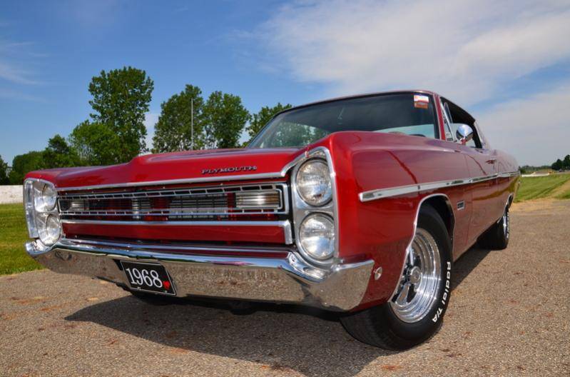

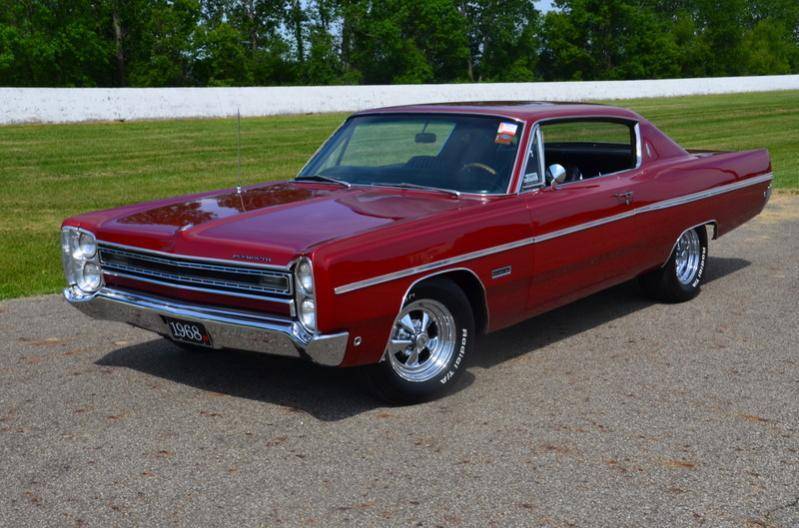

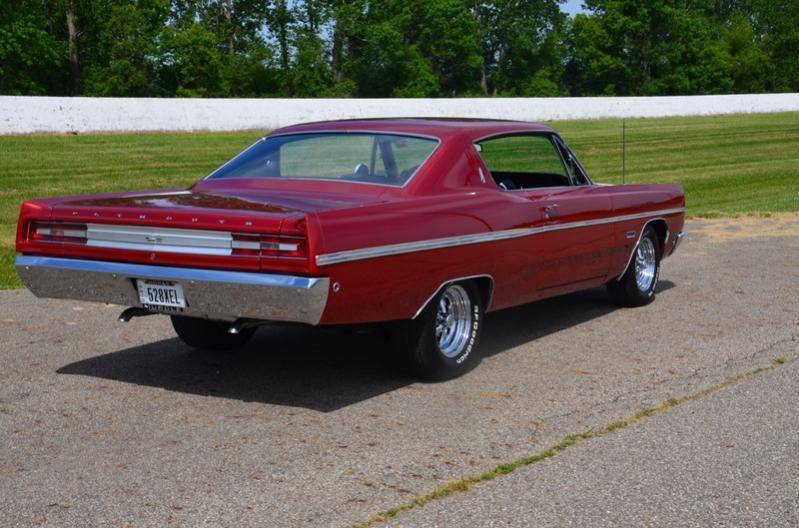

I did a complete repaint with the paint in question and had no problems at all. In fact I have had several people ask what I used because they want the same thing. I will try to post some pictures Joe IMG_0491.jpgIMG_0486.jpgDSC_2928.jpgDSC_2977.jpgDSC_3060.jpg
