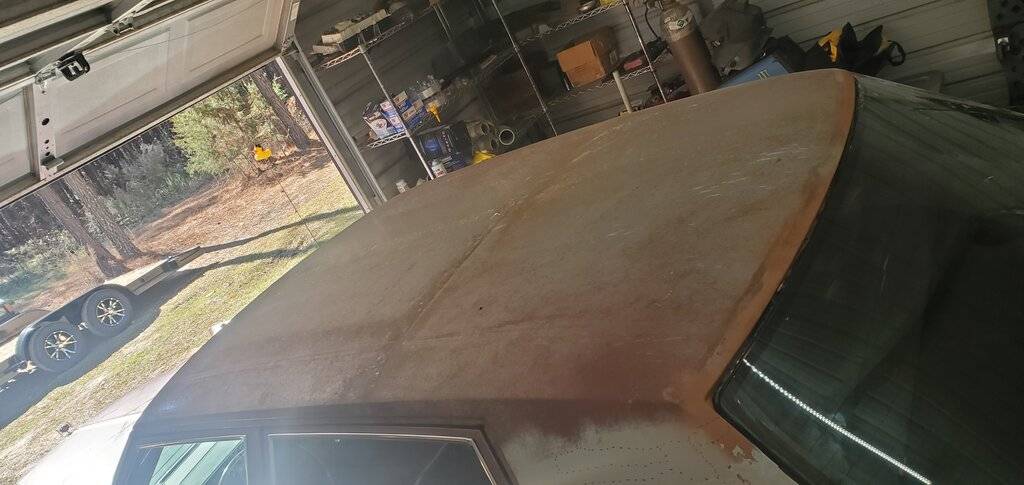

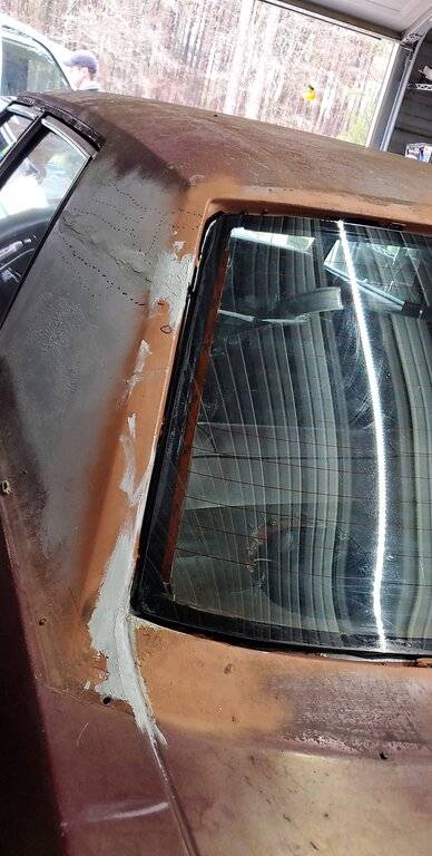

My Newport used to have a vynil top. I removed the top due to some decay where it had peeled up. Afraid it was going to collect moisture. Finding that the vynil is going to cost $500+ after shipping and take months to get here (and also being 1 step away from having the car back on the road) i decided to paint the roof.
My question is what is the best way to remove all that old adhesive? Alot of it is stuck to the roof still. I tried sanding it and it won't come off. Used a 300 pad a 200 pad a 150 pad 100 pad 80 pad and finally a 50 pad on a Dewalt sander (kind of like a vibrator. Sounds bad but thats essentially what this is)
Any help is appreciated. I have a picture of the decal I put on the windshield which includes some of the roof. All of it is like this. Ill get more pics tomorrow.

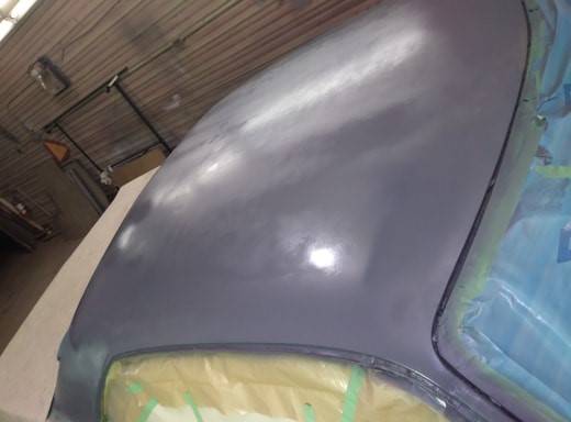

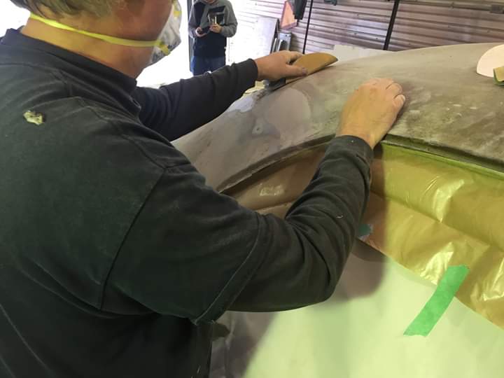

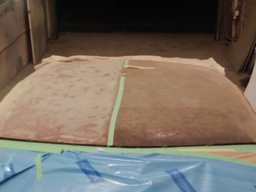

We used a DA sander. Smoothed out the seams and then sprayed epoxy primer on the roof. The lighter side was sanded and the darker side has glue still on it...
This is what u was thinking more of. I have the tools to do this with a drill or impact, just didn't know how effective this would be. Apparently very effective haha. Of this keeps from messing my roof up and my paint then I feel like this is the way to go.

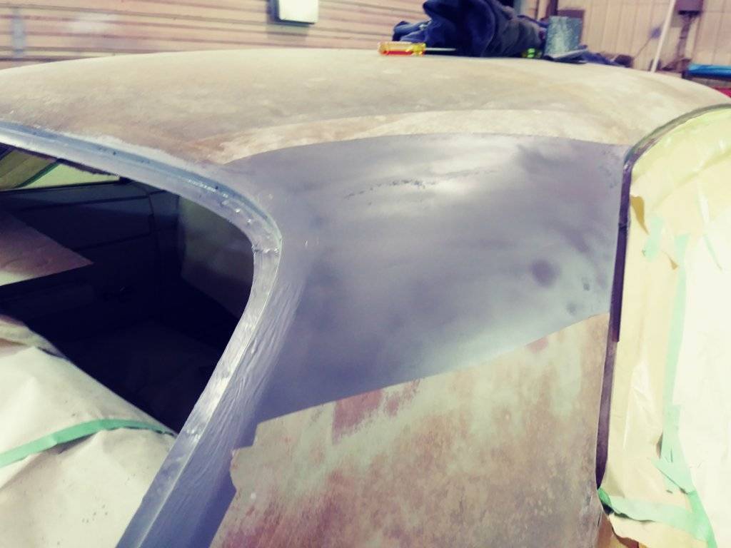

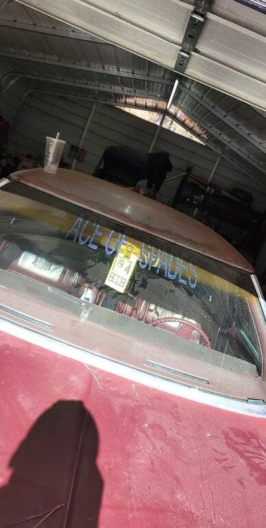

Its kind of hard to reply to all of the messages at one time so im going to post the pictures and tackle all 3 replys here.
Robert that is the plan right now, I've been looking at painted roofs and I kind of like the look when they're completed.
Cbarge I see what you're doing there. I do have a little more Pillar work to do but my roof is actually welded on way further down the Pillar probably a solid 4 to 6 inches further down.

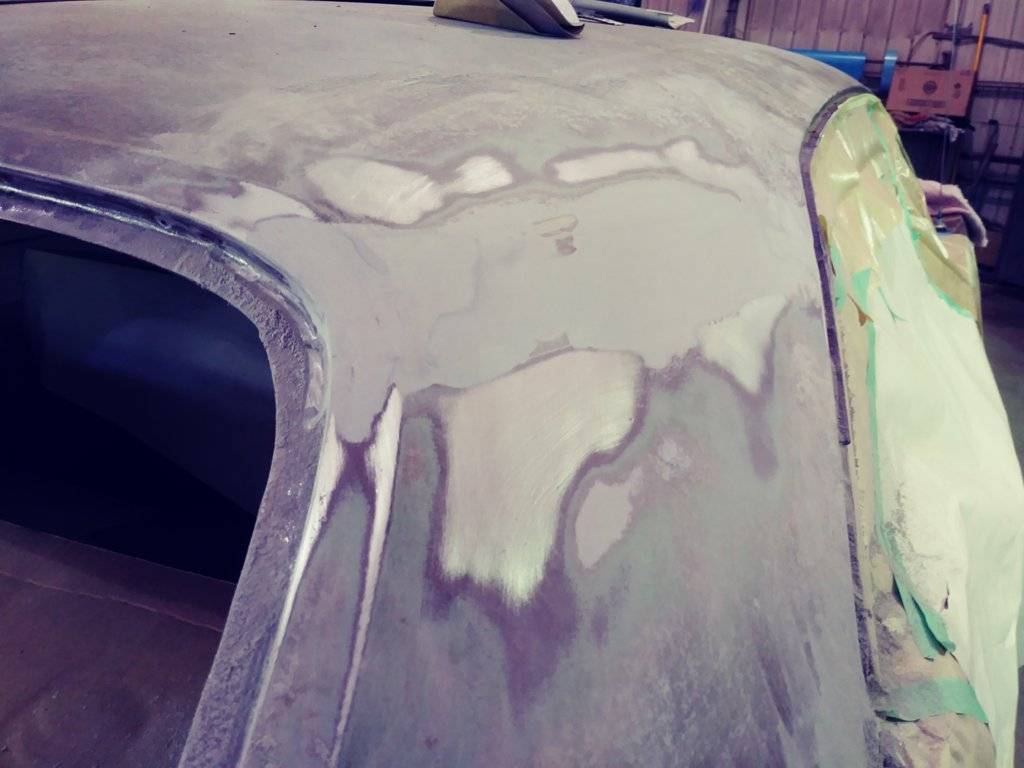

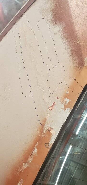

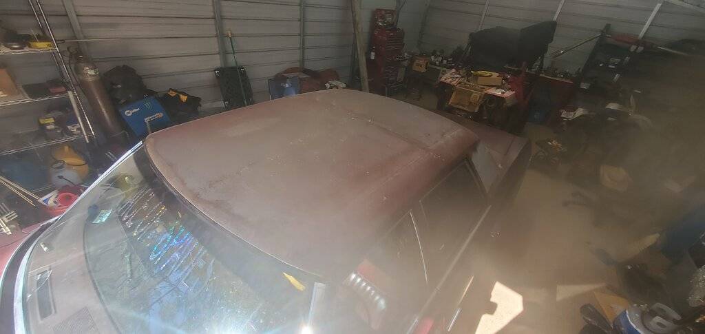

Pictures as promised:
I already worked on sanding this side and the other side today
