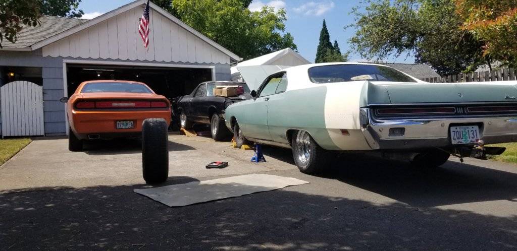

My 300 has a cheap respray it looked ok when I got it. But its really flat now. The prep work was insufficient as typical. When I first got the car I had to rebuild the dutchman panel. I had intended to paint the roof at the trim line to mimic the vinyl top color scheme.
However, when I was masking off I had plastic sheet draped over the rear with a few spots of blue painters tape holding to the car so it would not lift.
At the end when I was removing the tape it was peeling the paint off! I was infuriated and was desperately trying to salvage it. But in the end that's how I ended up with the white tail. I just tried to incorporate all the spots into the roof work!
Its been that way for years. I'm putting a new roof on the car, so it will have to wait.
It's so frustrating, a little better prep would have made a lot better paint job!
My 68 Coronet on the other hand, had a better quality respray job in hemi orange. But they did the old double hardener in the enamel trick. It gives them extra gloss, and 25 years later that car will gloss right up, but the paint is extremely brittle.
Its got many spots where any rocks impact or anything else the paint shatters and flys off the car.
