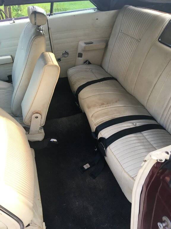

The previous owner set something black (rubber?) on the back seat. I scrubbed the whole interior, but these stains remain. Could I spray just the stained areas with some type of vinyl spray, or would it look worse? Maybe spray the whole seat bottom?
The previous owner set something black (rubber?) on the back seat. I scrubbed the whole interior, but these stains remain. Could I spray just the stained areas with some type of vinyl spray, or would it look worse? Maybe spray the whole seat bottom?View attachment 409826
Looks like marks from a tire.
Have you tried some Simple Green? That stuff is very good in my opinion.
I spent all of Sunday giving the interior an initial wash with Simple Green. Had rivers of brown gunk running off the white vinyl. Also tried a little clorox just on the vinyl stains. No improvement. I want to someday buy a fresh interior, but right now, i have bigger fish to fry. (Mechanical).
Most paint shops can mix vinyl color in pretty much any shade. It is a temporary fix but would probably get you by for awhile. It is designed to be sprayed onto door panels and such that are discolored.
