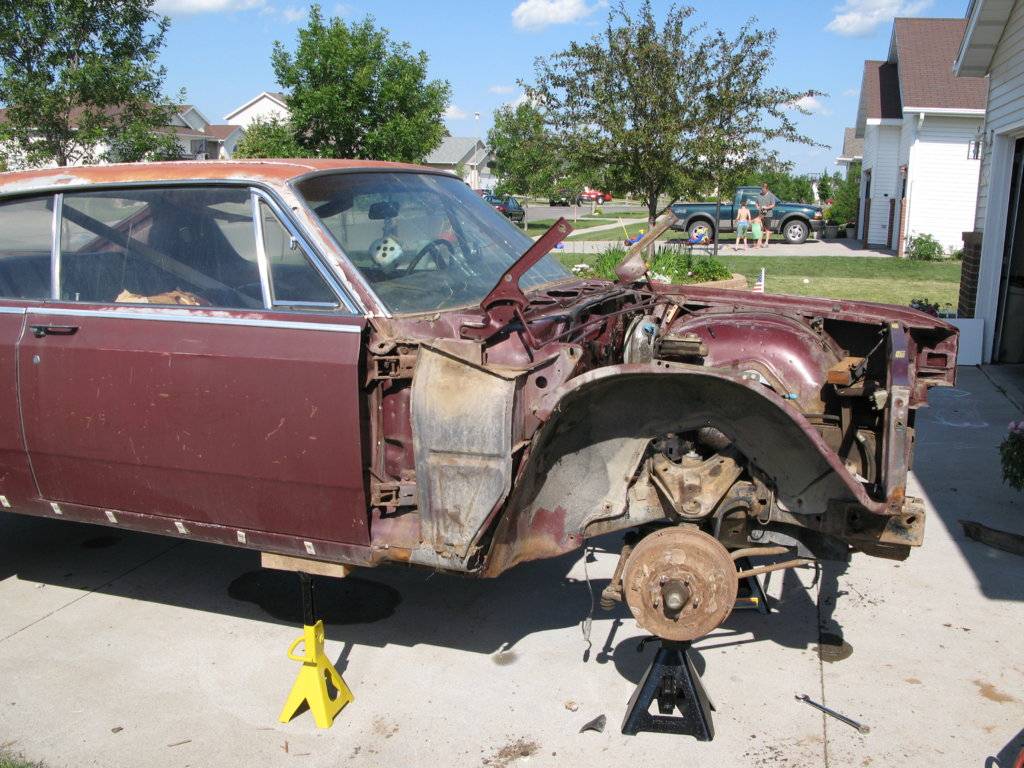

    I found a picture of the inside wheel well. It was body color then undercoated. Of course if you Are under coating black, it doesn’t really matter what color is under, but should be painted for extra protection if the under coat starts lifting or chipping.
    For the restoration my rears were under coated then painted body color. Depends if you want original looks, or are just going for the protection.
