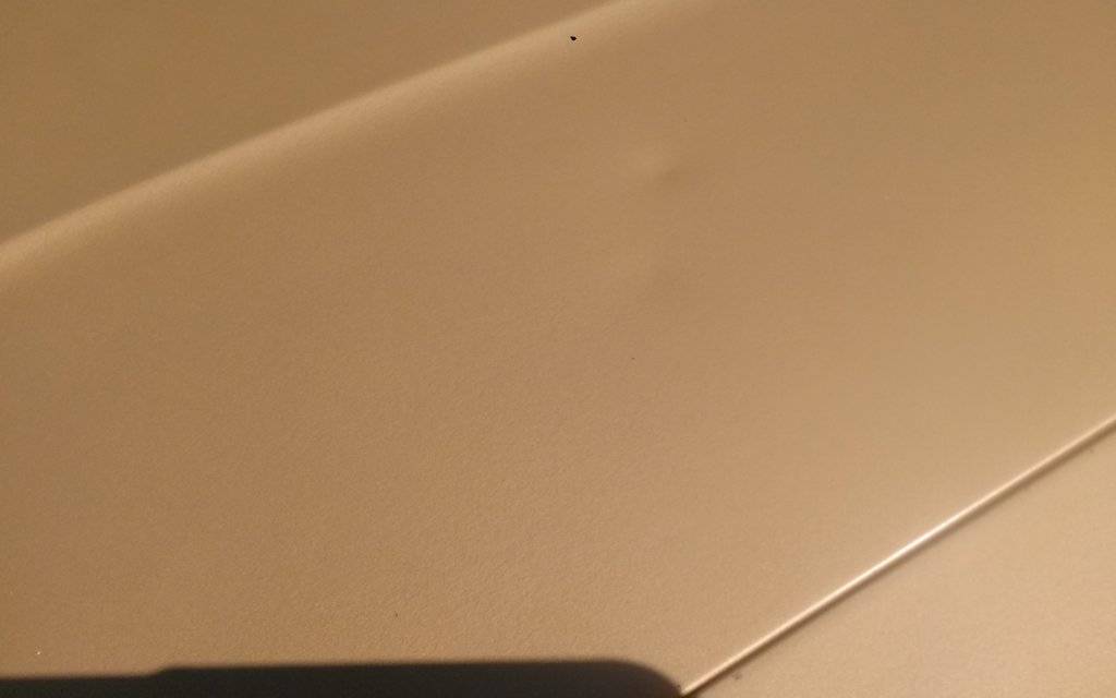

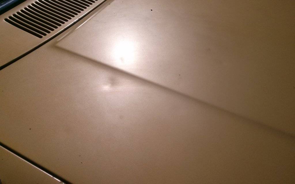

    Here are some pictures of what I am dealing with

    First one, might work. 2nd one... I think it's too close to the ridge. It might lift it up SOME, but not gonna look as good as it did.

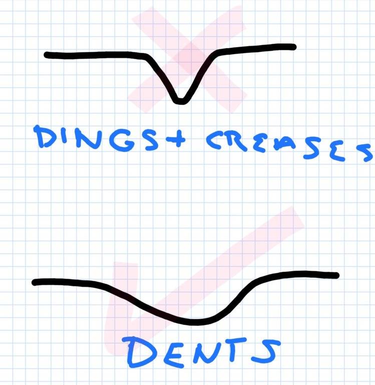

    The truth about paint less dent removal:
    REAL paintless dent removal pros don't try to pull out "dings and creases" using suction cups and glue guns. They use them on "bumps"
    Dings and creases have to be massaged out from behind using special design rods and paddles by hand. Drilling holes in panels many times is necessary to get behind the ding.
