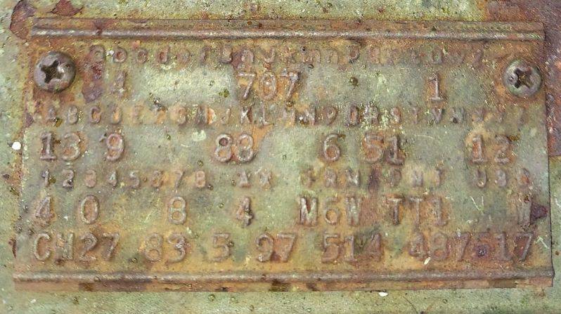

Got a pair of tags here, I'll post the second one in a bit, here's the first one with my results, looking for an accuracy check:
Is the scheduled build date May or April?
So looking for b1, R5 radio option, 97 unknown tire code
b1: unknown option
h7: fender top turn signal indicator
j0: Tilt/Telescoping Steering Column
k7: Passenger Outside Manual Mirror
u1: ordered car
A1: 26in Radiator
B3: cruise control
D9: Front Disk Brakes
J8: Remote Trunk Release
K8: Power windows
P6: Rear Seat Speaker
R5: radio (unknown type)
S1: Air Conditioning
X1: tinted windshield glass
Y2: white convertible top
14: Sill mouldings
30: Body Belt Mouldings
78: Wheel Lip Mouldings
A4: 3:23 rear axle
TRM = M6W vinyl bucket seats white on black interior
PNT = TT1 Meadow Green Metallic
CM27 = Chrysler 300 2 Door Convertible
83 = 440cid 4-bbl HP V8
5 = spare tire
97 = tire code (unknown)
514 = Scheduled build data April 15
487517 = what is this again?
VIN: CM27L8C302497
C: Chrysler Newport / 300 / New Yorker
M: Medium price class
27: 2-door convertible
L: 440 cid/375hp 4-bbl
8: 1968
C: Jefferson Avenue Detroit plant
302497: Sequential production number
b1 = 561 - Seat Springs HD Front
R5 = 425 - Radio AM/FM Search Tune
5 = 395 - Automatic Transmission
97 = 8.85x15 White Wall
487517 = Shipping Order (no real value)

The lone 5 next to the 83 is automatic transmission.
I thought that sometimes a spare tire is somehow indicated on these tags. ?
8.85 x 15 Seems like a pretty wide / non-standard tire. I thought the widest they got was 8.55
BTW, how is Newport / 300 / New Yorker coded? Is it just the Low, Medium and High price code? The "M" in CM means 300?
And 5 codes for April? How does that work?
Tire code is 2 digits in 68. 3 digits in 67 and the last number is how many and it's usually 5, sometimes. They have a 4

I used a few different sources to piece together the first tag (the beat-up tag) in this thread, then I plugged in the entire tag here:
It seems to have gotten everything right - it didn't know the R5 radio code or the 97 tire code. or the b1 heavy-duty front seat spring code (thanks @MrMoparCHP for those). Who ever ordered this car must have been on the heavy side, even ordering the 8.85 wide tires. But not for trailer towing (no trailer hitch on the tag). It says the date code 514 is April 14, I would have thought that was May 14, so I'm wondering about that.

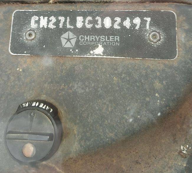

One more thing - here's a picture of the VIN plate on the dashboard. Any ideas what that switch is?

May. 5 = May and 14 = 14th scheduled day
Both cars code b/4 (not b/1) = code 564 = bucket seats which jives with the M6* Interior code
R/2 = code 422 = Astrophonic A/M radio.
R/5 = code 425 = AM/FM
With the introduction of the six digit SO number for MY 68, as opposed to five digits used in 67, something had to go on the bottom row so the 4/5 tire code that existed in '67 got dropped.

Part of the Safety Sentinel headlamp system.
It is a photo cell to turn on the headlights when it gets dark enough.
