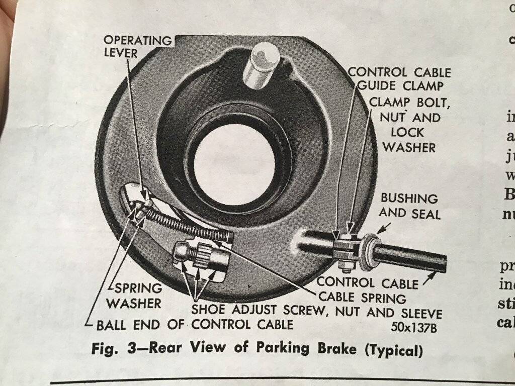

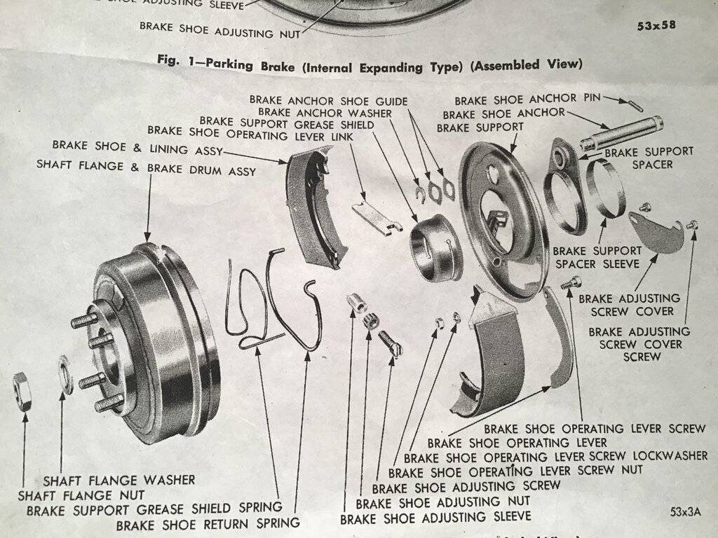

These brakes can work good. I’ve head many that did. They need to assemble it correctly. Do you or they have a factory service manual for this brake? There are parts that only go in one direction.
There is and adjuster between the shoes. Did they adjust it there? Read what the manual says about an adjustment on the cable. Bold print in paragraph 3. And they say that’s how they did it. Looks like we found the problem.

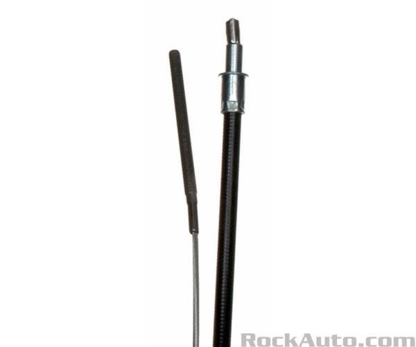

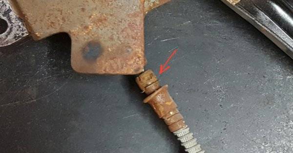

Looking for some insight on how to fasten the front parking brake (e-brake) cable since the new cable does not come with the "squeeze"-type retainer that holds the end of the e-brake fitting in place at the pedal or chassis. Any ideas how to hold the new one in place? I've attached a couple of pics of the old-style clip and the new end without a clip
