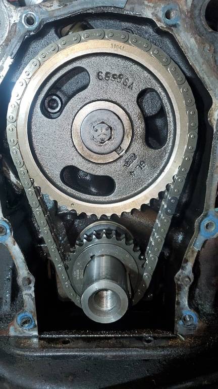

Welp, I pulled apart the front of the engine just to find the Timing Gears/Chain has already been replaced before me. Its a comp cam 3104
Hi-Tech Roller Race Timing Set for Single Bolt Chrysler 383-440
So I guess now what are the chances that the cam and lifters have been already upgraded on...

I hate to be negative but there is a pandemic of cam and lifter failures.
Despite many different brands of cams out there, only 2 companies actually manufactures NEW lifters.
So do your homework and choose wisely.
Me?
My wagon is a victim of this pandemic.
Wiped out lobes in #4 after the lifter pumped up solid.
Replaced the cam and lifters and again wiped the lobes and this time destroyed the engine with metal shavings from the wiped lifters.
I will echo Leaburn's warning about lifters. I was not happy with Comp lifters that I installed in an engine I built 15 years ago. They were made to poor tolerances and would bleed-down while the engine was running and the valvetrain would always clatter.
I recently went to purchase a new cam and lifters for the same engine. I bought another Comp cam, partly because I already had a good Cloyes 1-bolt timing set I was reusing, otherwise I may have gone with Lunati. Lunati cams use a 3-bolt timing set like the 426 Hemis originally used.
The knowledgeable owner of the speed shop I use, who is an engine builder and drag-racer himself, said that the quality of Comp lifters has just gotten worse since I bought my old ones. He recommended Crower "cam saver" lifters, but they were out of stock everywhere, so he ordered me regular Crower lifters instead. If my new Comp cam fails with someone else's lifters they won't honor the warranty, but their warranty isn't worth a thing, they'll find an excuse not to honour it anyhow. Fortunately the cam break-in was successful.
