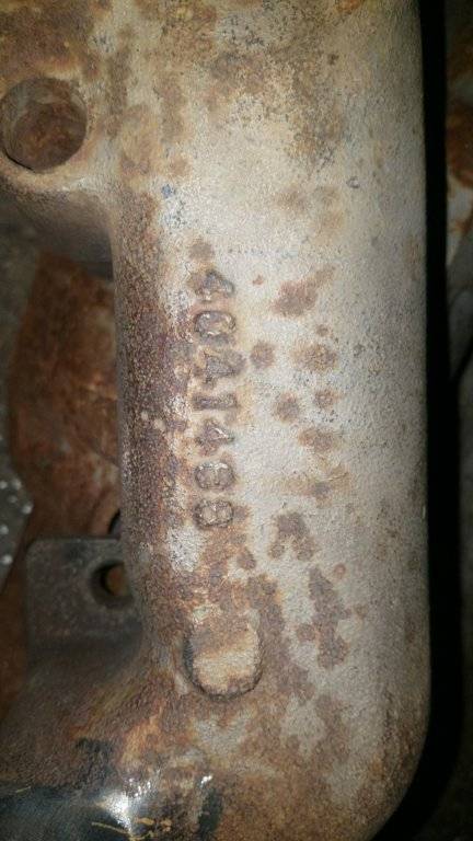

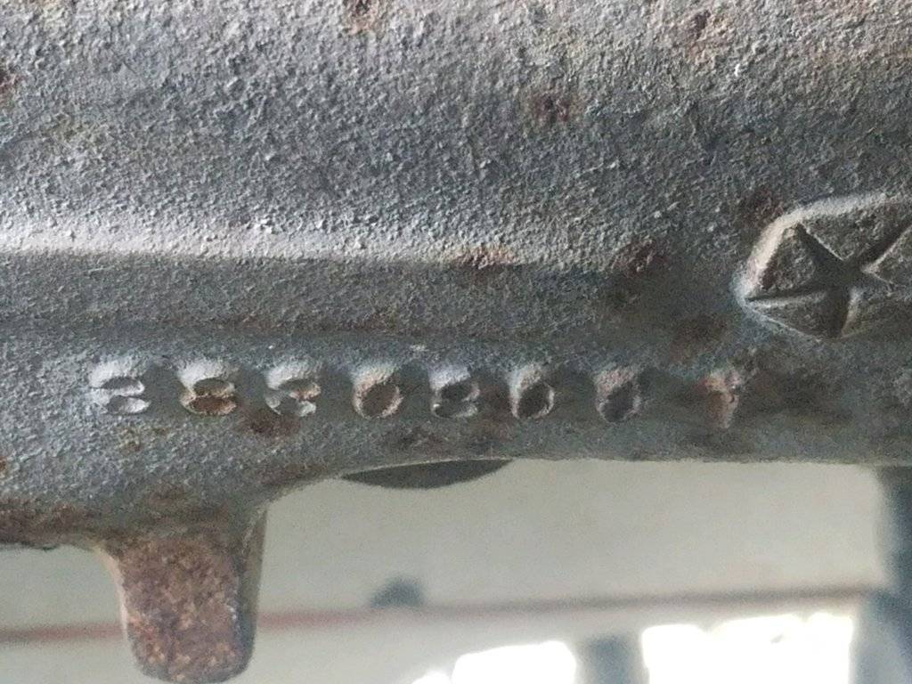

well didn't get it off the car but heres the best pic I could get of the casting number.
Ive had that truck for 6 years now and paid $500 for it. Its my beater truck/winter truck.
Is that 3880800? If yes, that is the incorrect left side exhaust manifold. Photos of the entire manifold and the right side manifold casting number would be helpful so that we can give you recommendations.

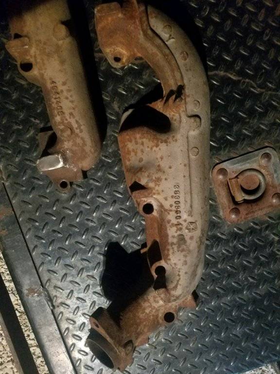

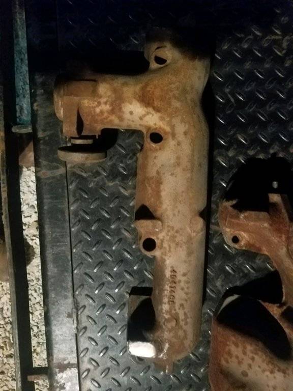

Well, here is what was on the driver's side.. Don't think they're the right ones for the car. IN SEARCH OF THE CORRECT MANIFOLDS
I will try to remember to look over the weekend and see what I have. The right side HP exhaust manifold was also used on B Body's as well as on C's for several years. Since they were also used on B Body's they are hard to find at a reasonable price. I would suggest using the 70 - 71 C Body left 440 HP exhaust manifold. Not sure if it was still used in 72. They are unique to the C Body 440 and somewhat hard to find.
The passenger one looks like it will probably work, but the driver side one hits the steering coupling. The driver side also dumps towards the drivers door direction. The guy I got the car thought it was gonna work I guess and I'm finding out he cut alot of corners on it.
