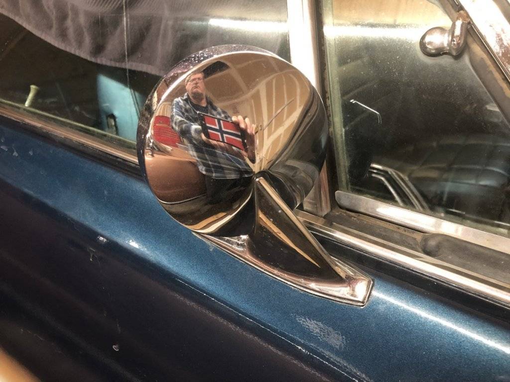

This is a 69 mirror, keep in mind the Fury is different than the Dodge/Chrysler

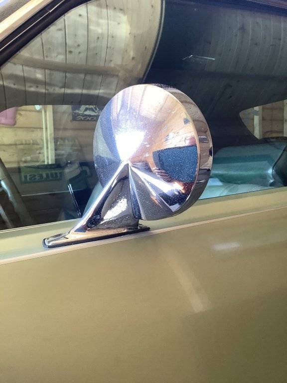

Our Fury and 300 mirrors. Different for sure. And neither one seems to look like the aftermarket mirror. Like you guys say..

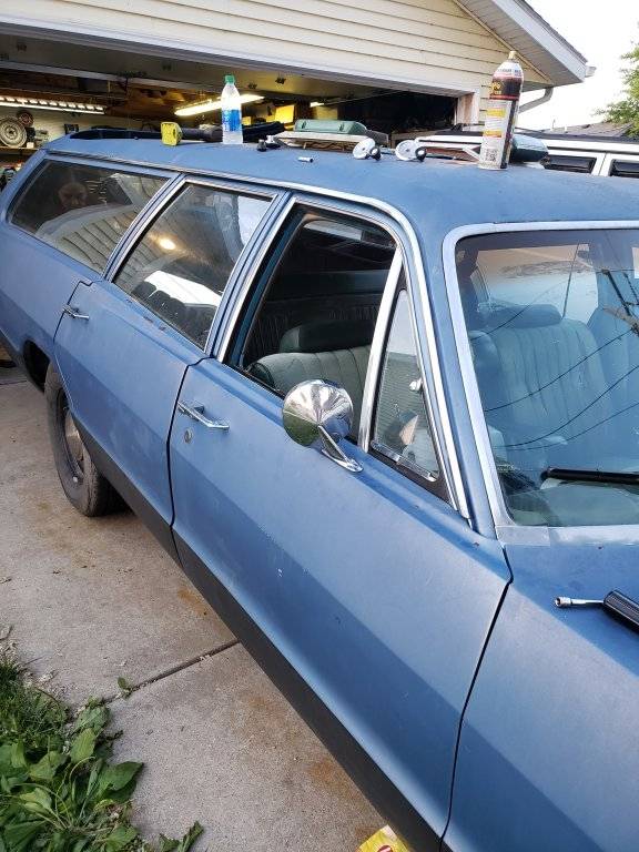

Keep and eye on Ebay there was a 69 70 Plymouth mirror a few months back didn't sell but not cheap. Here's a picture of one on my wagon of it helps for comparison in the future.

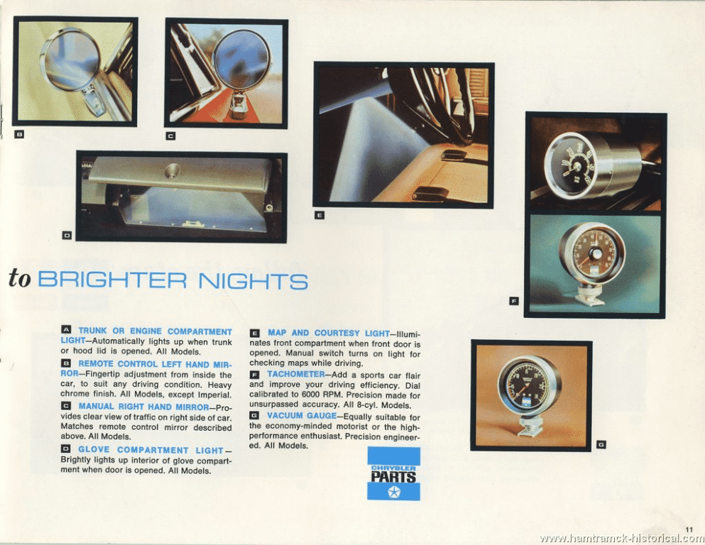

From the '69 accessory catalog:

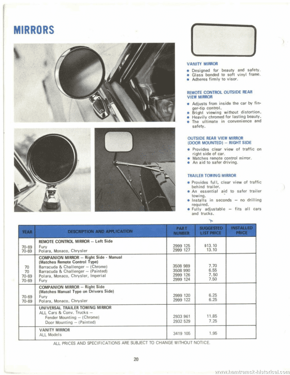

Here's the '70 accessories catalog. This shows the difference in mirrors. When you look at the '69 or '71 version, the differences aren't clear and the '69 leads you to believe everything fits everything... Which it really doesn't.

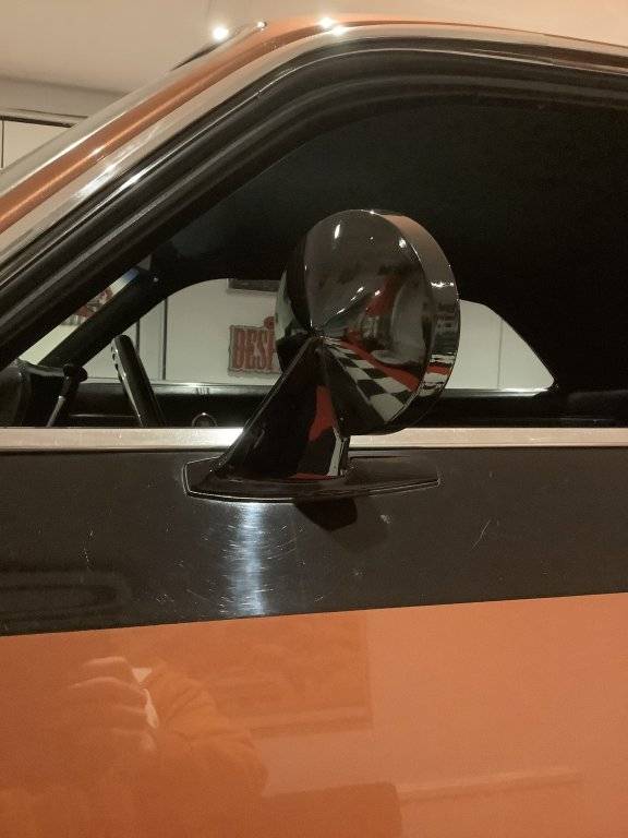

The right side manual mirror on my '70 300 and it's a matching mirror to my left side remote mirror. This is an accessory mirror, as evidenced by the external screws. A factory installed mirror will have hidden studs with nuts that you can reach from the inside of the door. The accessory mirror (if it's NOS and everything is still in the box- doubtful) will have an insert that you drill 2 holes in the door (gotta be brave LOL) and then put the inserts in. The machine screws for the mirror go into these inserts and squeeze them so they expand and stay in the door.
