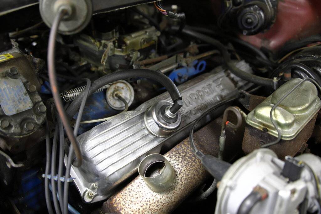

Hey guys this gonna be a short one...
Received my favorite VC finally and just wanted to make sure how and where to install breather and PCV.
Gonna go with Breather on Passenger and PCV on Driver Side. Oil fill Cap?
1. 2 big holes with baffles are already factory. So i was wondering where to put what and what to do with the oil fill cap. SOme people told me its totally ok if I use the factory holes for Pcv and Breather and just remove the breather to refill oil. Will the twist in MP Breather (the one I got) seal again after twisted in and out several times?
2. Position. Breather would be back side of VC passenger and PCV as a consequence of not drilling a sealed hole on the front side of driver side. Is that working or does the PCV HAS to be on the back side of the VC too like the breather?
As a whole I would surely prefer to not drill any holes just to minimize the risk of breaking something if the holes that are already there will work fine.
3. IF I drill in one sealed hole I do have to isntall a baffle below too right? How do I attached it because screws aren´t the proper way I guess.
I am excited to see how you guys did it.
