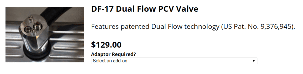

    I agree with those above. Keep the PCV.
    :wideyed: No time yet to read anything, but that's a hell of a price for a PCV. It can't be THAT much better than a factory spec unit can it?

    Think I'll stick with a basic factory style setup

    the thing is factory pcv’s have springs tuned to every cars/engines respectable vacuum range.

    Do a little reading, you just might learn something, I know I did. It is more than just a good pitch IMO.
