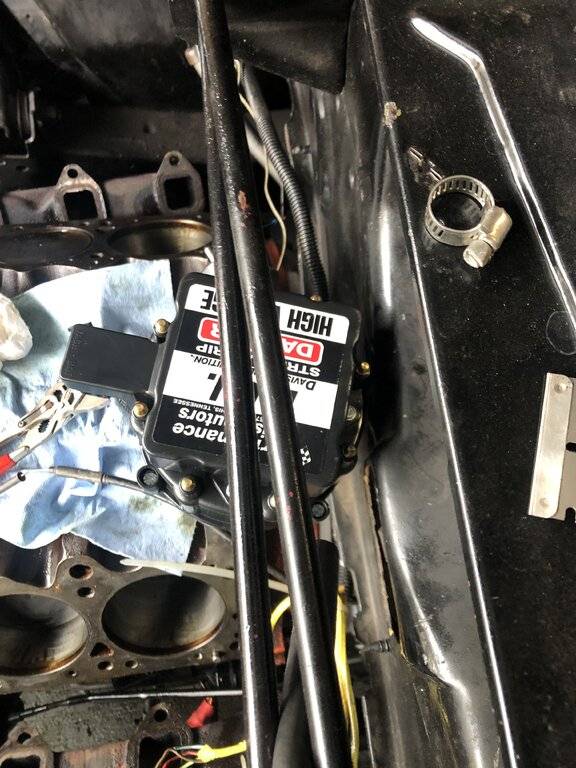

    Hey guys I bought a performance distributor for my poly 318 in my 66 fury. It fits.... barely but I am excited about getting the car running on it. My question it if anyone else has run this setup and what you did for a fused line, did you run it just right off the battery and fused it or if you put a line off the fuse block in the dash.

    They say on the website not to go to the ballast resistor. Apparently this style of distributor eliminates the need for it in the system.

    DUI uses something like a GM HEI adaptation (GM HEI only needs a keyed 12v wire to make it work, no inlne ballasts or anything). Wire it as DUI (Davis Unified Ignition) says to wire it.
    The "power" is in the advance curve, not specifically the electrics of the distributor. Even if the coil CAN produce a 50kv spark, if the plug only needs 10kv to fire it, that's all it makes, for example. It can be nice to have that much reserve, if needed, though. Add some new Iridium plugs for a better ZAP (due to their "fine wire" electrodes).
    Enjoy!

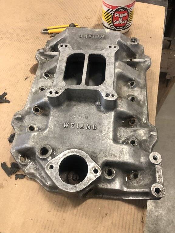

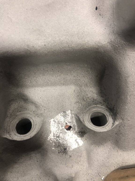

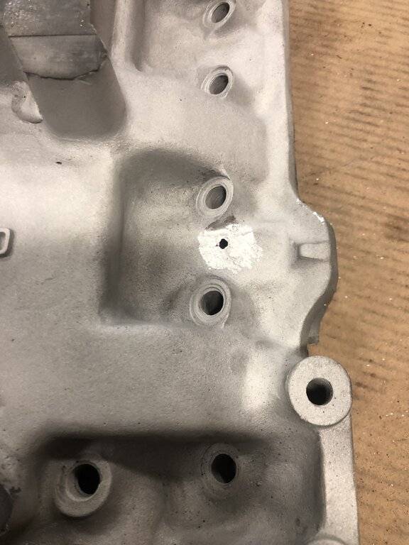

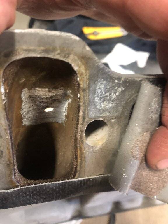

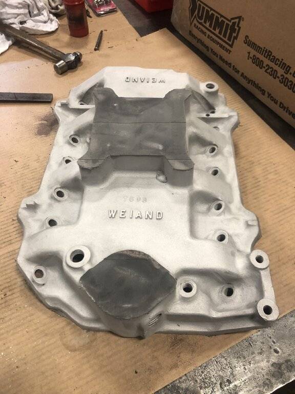

    I have been slowly getting it all back together. I took the manifold to my dads shop (has his own hot rod shop) as it had a small weep of coolant coming out of it. Went to centre punch the spot and it put a hole through it. Someone had done a repair on it a long time ago and the area is so thin we can see a flashlight through the metal. In the process of repairing it now.
