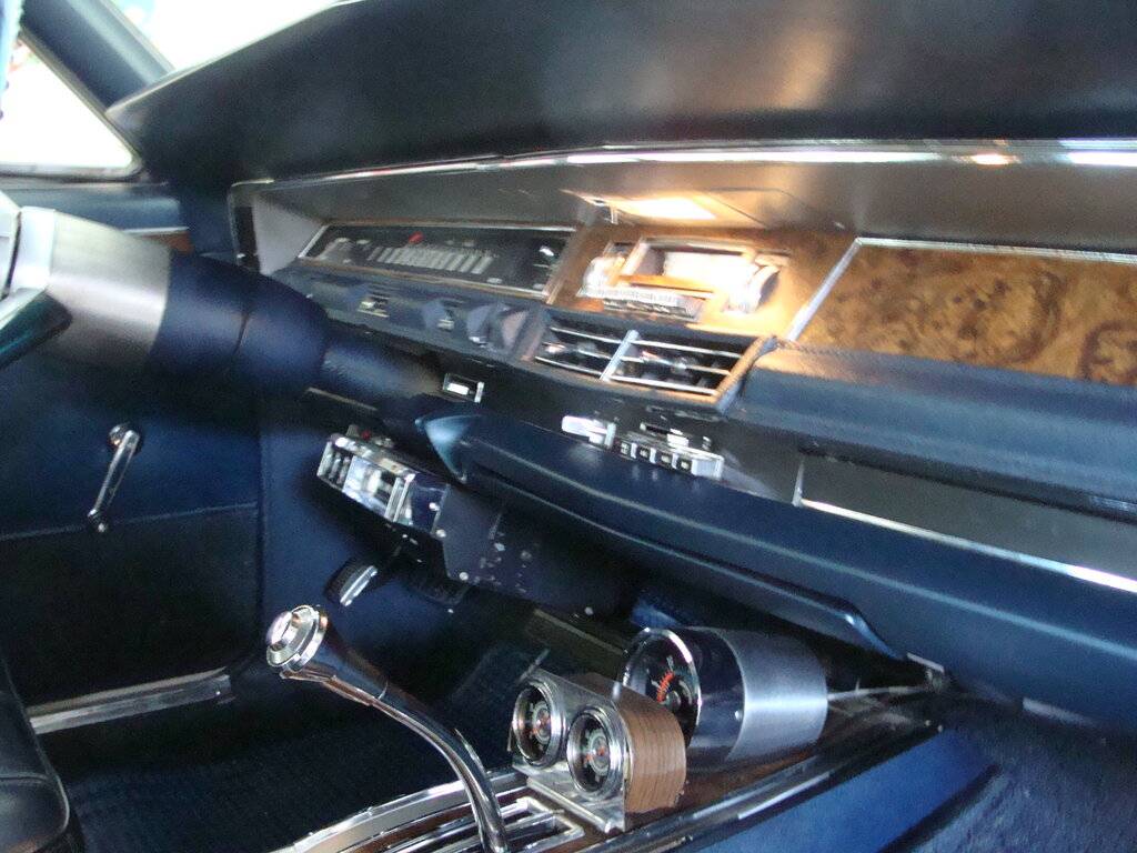

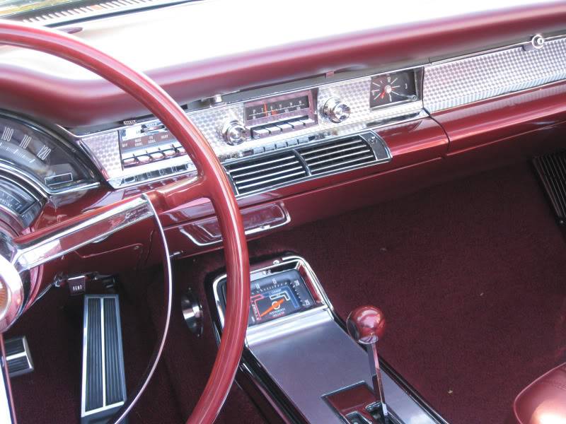

Consoles had special brackets welded to the trans tunnel to which the console was bolted.
Consoles were available with "shifter delete plates" - a 4 speed top was used and a ribbed plate was screwed in place. Extremely rare.

There are 2 different styles of gauge being discussed here. The Chrysler interior, including the center console, was redesigned between 1965 and 1966. Based on his profile pic, @ideologist has a 1965 New Yorker, so the console pics that @rexus31 posted are correct. The pic that @GOLDMYN posted is the 1966+ style console and gauge housing.

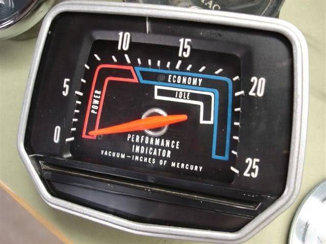

I’m talking about a 66-68 Chrysler vac Guage is the same hole size as the 65 Barra tach , We are not talking about 65 Chryslers here , it’s 66-68 .
You are on the wrong track .
Actually I think we are talking about 1965 Chryslers here.... That is what the OP has, and he didn't provide a picture of the actual vacuum gauge that he purchased so we don't know whether he got the 1965 one or the 1966-68 one.
