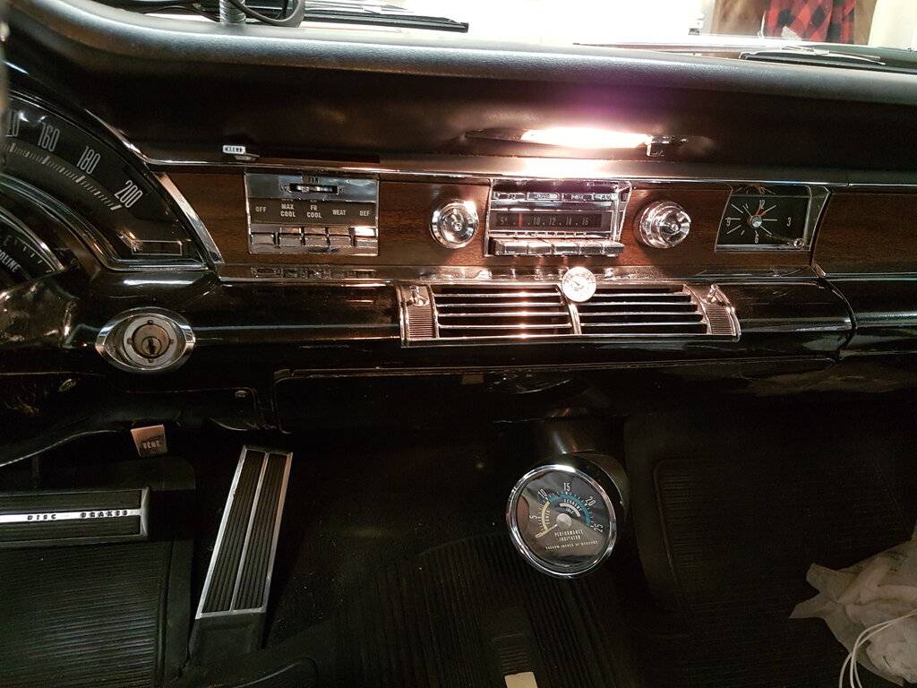

FWIW I mounted my vac gauge (66 style) on my 66 T&C's dash by turning it upside down in the housing and using a black plastic cap from a spray-bomb as a filler. Looks right at home!

Here's a pic of ny vac gauge mounted to my 66 T&C dash:
I could be wrong here but it appears that the 66-68 B-body cars had a console mounted tach that uses the identical housing as the Chrysler vac gauge. That could be an option. As for mounting it without a console, could you not turn it upside down and drill a mounting hole in the underside of the dash? I imagine the gauge could be turned in the housing.

That's correct, same housing. Mounting it under the dash is exactly what I did with my wagon - see the pics in my post above.
