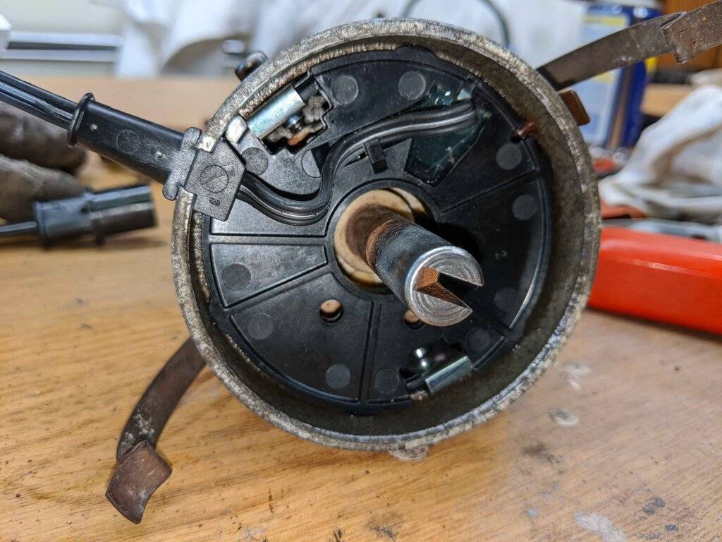

Pickup: Shutter passes through opening, bottom left. No adjustment.

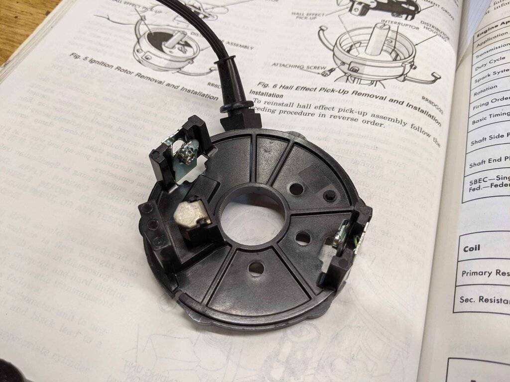

Top of pickup, 2 screw install

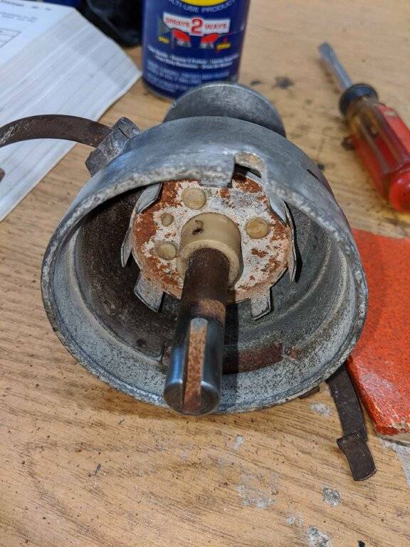

Hall Effect Shutter, below pickup
New pickup installed, (NAPA Echlin MP827)

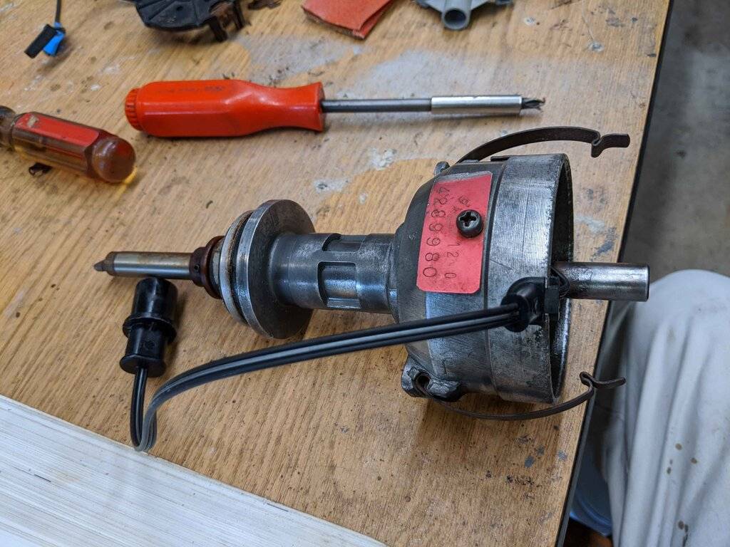

1990 Distributor for 360 SB

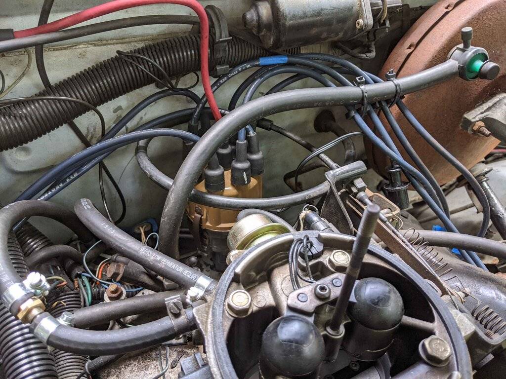

Hall Effect Distributor looks completely stock
