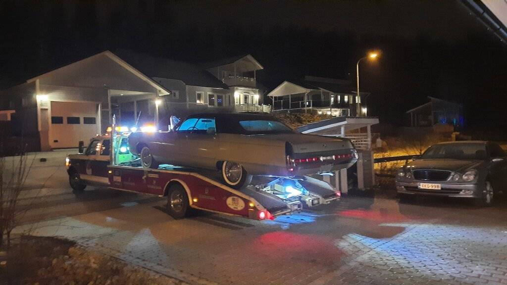

After a long, looong wait it finally was dropped off to my yard by Santa on December 10. He's quite busy at this time of the year and has to start early. Starting from the biggest gifts and nicest kids ;-) And forget that nonsense about Rudolf and sleigh and such, in reality Santa drives a F-350 tow truck! And he has a gold '69 Imperial himself! I didn't know that when I wrote to him asking for the delivery - what are the odds!?

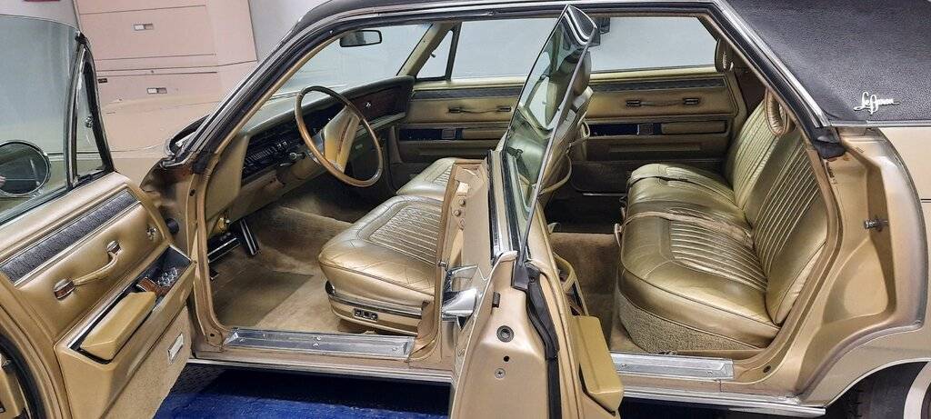

The car seems to be pretty much as I expected, definitely better than the worst case scenario, after all it runs, drives and stops! Well, I only drove some 100 meters in my yard, but anyway. And seems to be very intact and solid except for a small rust hole at the RR door opening, an easy fix. Biggest setback so far has been the moldy interior. I've spent one week cleaning it as much as possible without taking it apart (well took out the back seat and found couple of mouse nests), but still can smell the mold. Hopefully good ventilation, time and perhaps ozonizing will help me get rid of it. At least the interior looks very nice now. Overall a very good starting point, but in true need of serious TLC.

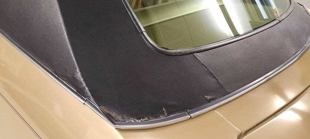

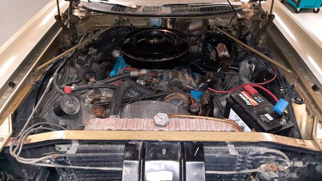

Today I finally finished cleaning the car. Very pleased of the result, the mold odor is now almost gone. Engine bay would need some detailing, but to my beginner's eye everything seems to be pretty much in place. And the otherwise perfect vinyl is shrunk from the rear corners - has anybody been able to have this kind of problems fixed other than replacing the whole vinyl?

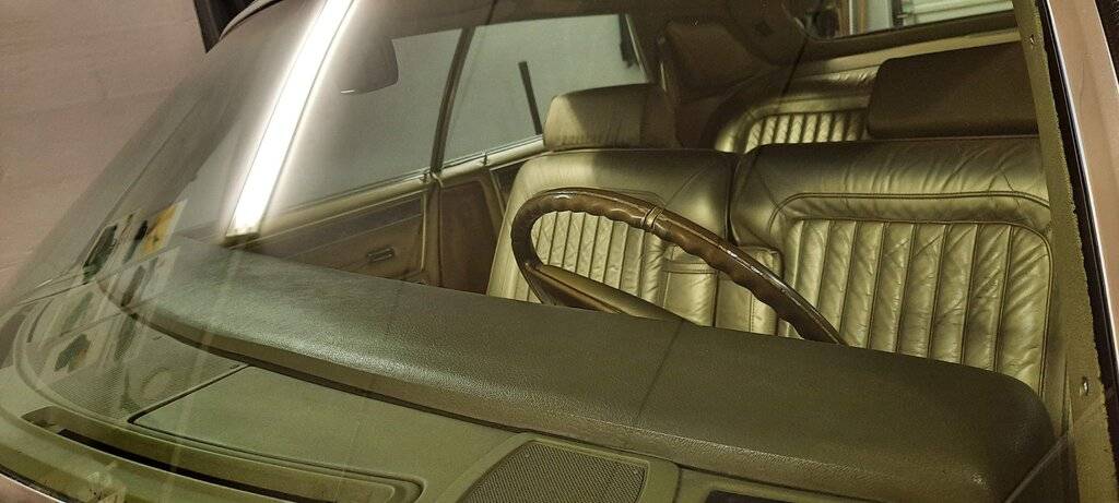

Windshield seems flawless, must have been replaced at some point. Also carburetor has a rebuilt tag on it and seems fresh.

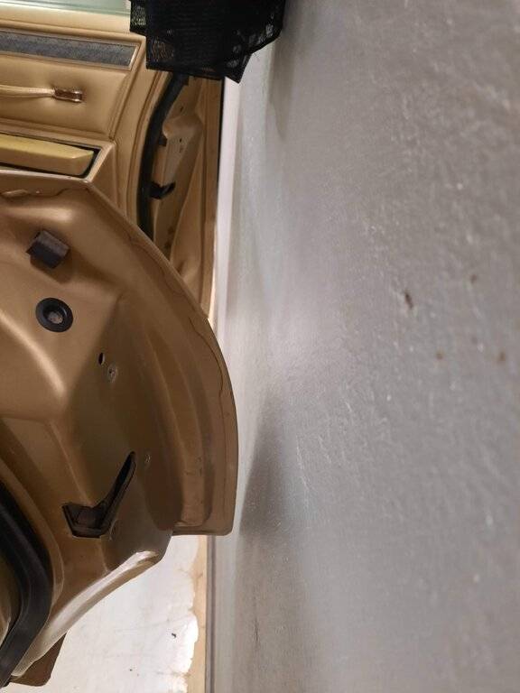

A 4 door seems to be a perfect fit for my garage. :lol:
