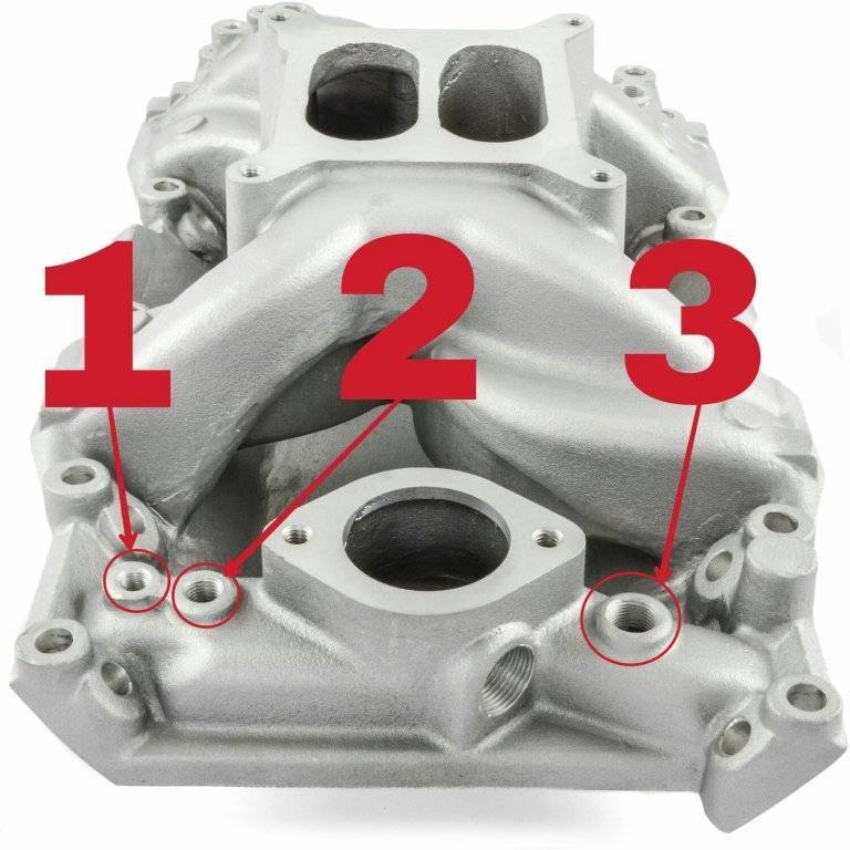

And which one is breaking your ballz?
What do you currently have in #1, #2, and #3.
Trying to get a PICTURE of what's going on.
I have a sensor for my electric fan thermostat in 2, water temp std sensor in 1. The rest are plugged with allen wrench pipeplugs. If i rip on it like a berserker, id either break the manifold, bend the allen wrench or round out the plug... but it wont move. The one i got out last year, i tried dry ice, heat, soaking it in all kinds of stuff, nothing.
