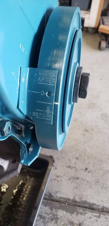

In 1972 and maybe even later Chrysler was using 6 pack rods on forged cranks in 440s and they definitely needed external balancing. If the motor has the original front damper it will have a offset weight cast in to it and the torque converter should have 2 small weights totaling 6.5 oz. I think most 72 440s had 6 pack rods, they were using up rods when they stopped 6 pack production.
That is a weight for a 360 cast crank the damper is neutral balanced, try knocking the weight off with a chisel. you might get lucky

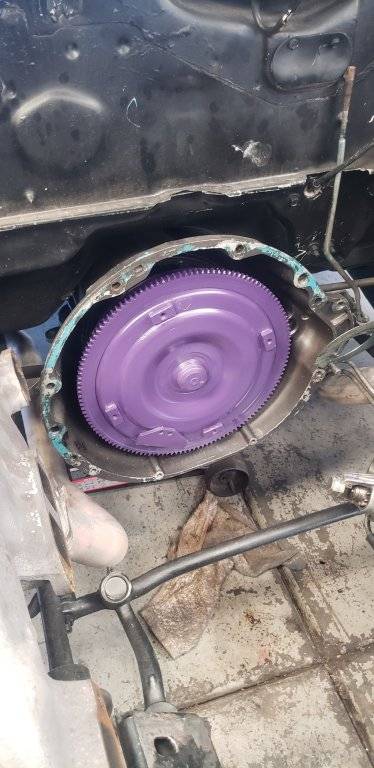

I forgot I had a pic of the converter taken as the 440 was getting set in there...
Took it for a long drive Saturday. Did great but the engine vibration is defnitely more pronounced. The rear view mirror vibrated so much it's hard to see out of. Kick it into neutral and the vibration stops.
You need to REMEDY this PROBLEM BEFORE it becomes a DISASTER. Don't drive it again until you have a stock TC, sans cast crank weights. If the flex plate is like that one from B&M which is made for any sort of TC, it should be fine for this.
No it's not going out until I can get the weight knocked off of it.
