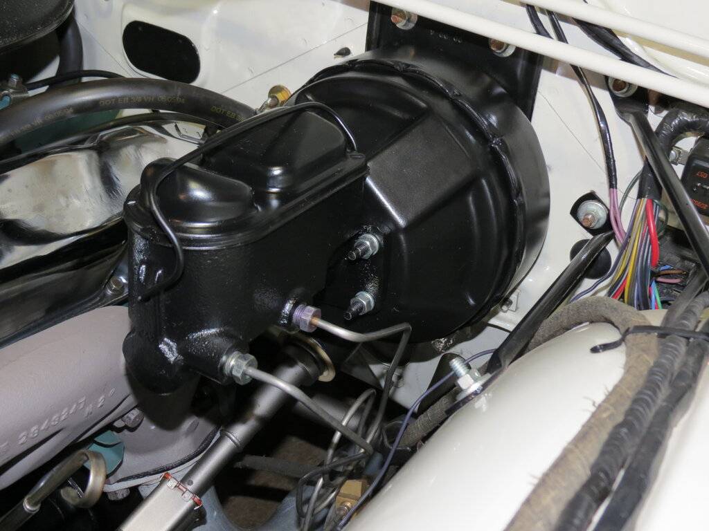

After borrowing a used (and rare!) 69/70 8 1/2 inch dual diaphragm from a member here (so that I could continue to move my car around for two months), I sent my unit to Booster Dewey/Steve in Portland as many of you here have already done or are planning to. Instead of a six-seven week turnaround as quoted, mine was back in about four. They under-promised and over-delivered!
The cost was a mere $200 plus $30 shipping. My shipping cost to them was about $50 (I put a high declared value on it, but they got antsy at "priceless"). Of note, I received my same unit back as promised, as I lightly stamped my initials on the bottom of the can. Besides, they don't have any cores of this booster anyway. Also of note, I did not send my check valve with the unit because I needed it for the borrowed booster. "Booster Steve" installed a new check, and that's probably routine regardless if you send a check with the unit or not.
Here's a before pic, with the borrowed unit on the left (which is currently in my car).
And the "unboxing", like the silly YouTubers do with their product reviews. The paint is purrrrfect.
Pushrod height was precisely 1 inch, just as it was went I sent it in.
Here's the paperwork.

That looks sweet !!
Yes it does! I should point out that my booster has led a sheltered life in a New Mexico and Amarillo environment in a continuously operated car such that there was no pitting of the can. It's clear that Booster blasts the can and does a very nice semi-gloss paint job, but they can't fix pitting, so YMMV.
Come to think of it, I wonder if they do a little "bodywork" on pitted units? Or, an industrious owner might send it out for a blasting and rebuild, and have it send back bare metal. Then that owner could apply a skim coat of filler, sand it all smooth, and shoot it with a quality rattle semi-gloss. Just thinkin' out loud.
Just had mine finished a few weeks ago, nice work & perfect function. They have a good sense of of humor as well, their included "booster nuts" were M&M peanuts, my favorite!
Those guys are a class act. I sent both of my DD boosters to them and at exactly 3 weeks, I was getting a call for payment. Fantastic service and workmanship. You'll be super happy once you get it on your car!
