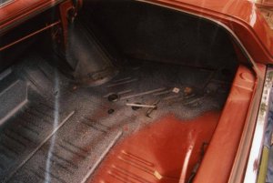

Trying to figure out where it goes, I know it wasn't in the stock location when I drilled the rivets out of it, while pulling out the old patches.
Trying to figure out my plan of attack for the trunk.
Nick
and Yes I'm full of questions:poke:
187134 2010 trunk carpet.jpg187134 2004  trunk  pan spare tire hold down.jpg187134 2004  trunk pan center.jpg187134 2004  trunk pan left.jpg

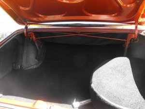

Hows this for ya?

It should be, 69 and 70 convertibles shared the same hold down and location
The convertibles are offset to make room for the top to set, otherwise you'll be breaking glass or tearing tops.
