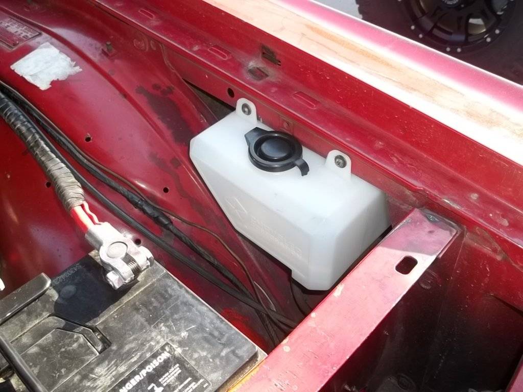

Can anyone please post some pictures of the location of the windshield washer pump on a 66 Polara? Just painted my engine compartment and obtained a new pump and reservoir (mine was missing). Looking for where the pump is located. I believe it’s near the certicard holder by the battery. Thanks!
Your pump is mounted to the rad yoke, just under the reservoir. The reservoir mounts with 3 screws to the sheet metal by the front of the driver side inner fender, screwing to the actual front fender inner lip.

I went out and took these. Obviously it's tough to get a good picture with the battery and washer bottle there.

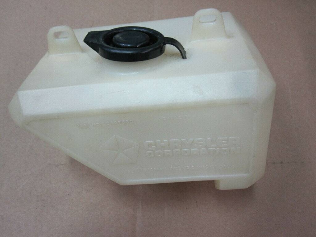

Where do they sell the washer bottle for this car?
