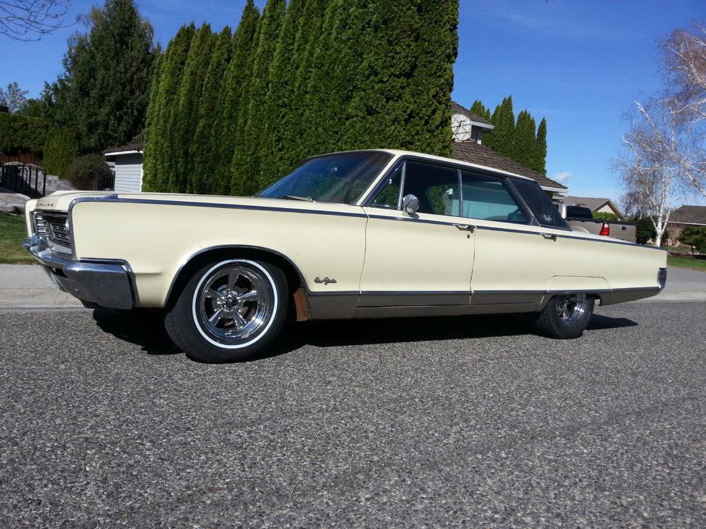

    Can we get some car pics ???

    Last summer
    • Like Like x 3

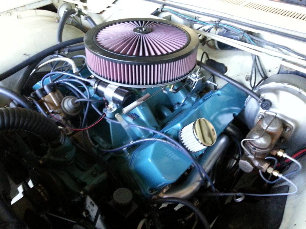

  10. MEV
    MEV Member
    Messages:
    159
    Likes Received:
    150
    Joined:
    Mar 28, 2015
    Location:
    WA
    build
    • Like Like x 1

  13. 440sportfury

  14. ph23vo
    ph23vo Well-Known Member
    Messages:
    618
    Likes Received:
    264
    Joined:
    Nov 20, 2010
    cool.. sleeper!....have you tried a factory dual snorkle stlye air cleaner?? i bet it would run the same.. and look way better..
