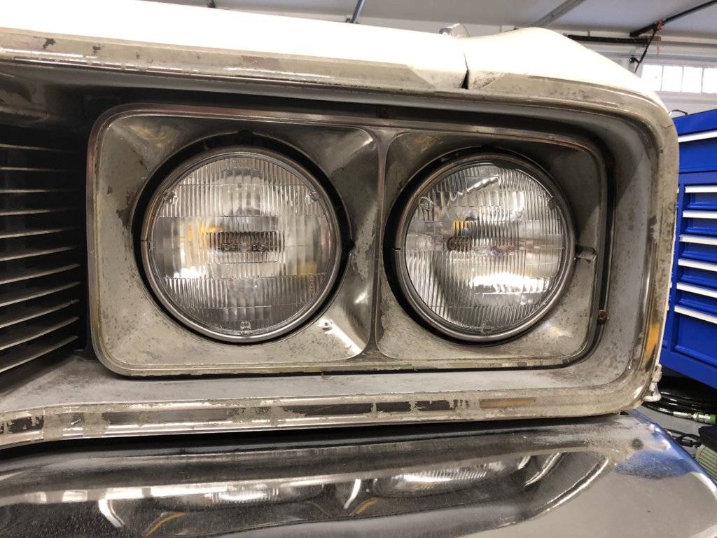

On my 74 Fury I have two intact headlight bezels, but the finish is shot. Should I keep trolling ebay for ones in better shape or is there somewhere I can send them to get refinished?
Personally , I would refinish the ones you have..
Remove them from the car, mask the chrome edges,scuff with 3M scotchpad and paint the bezel area Argent silver to match the grille.

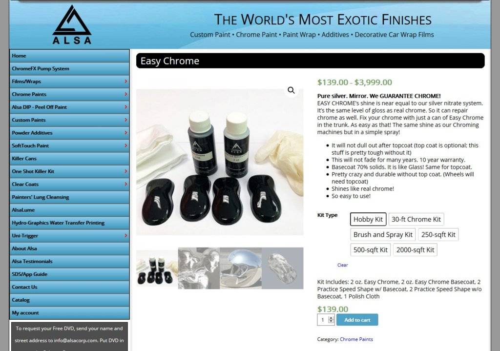

Here's another option:
There's also a different company with a very similar product. Spectra Chrome, or something like that.
