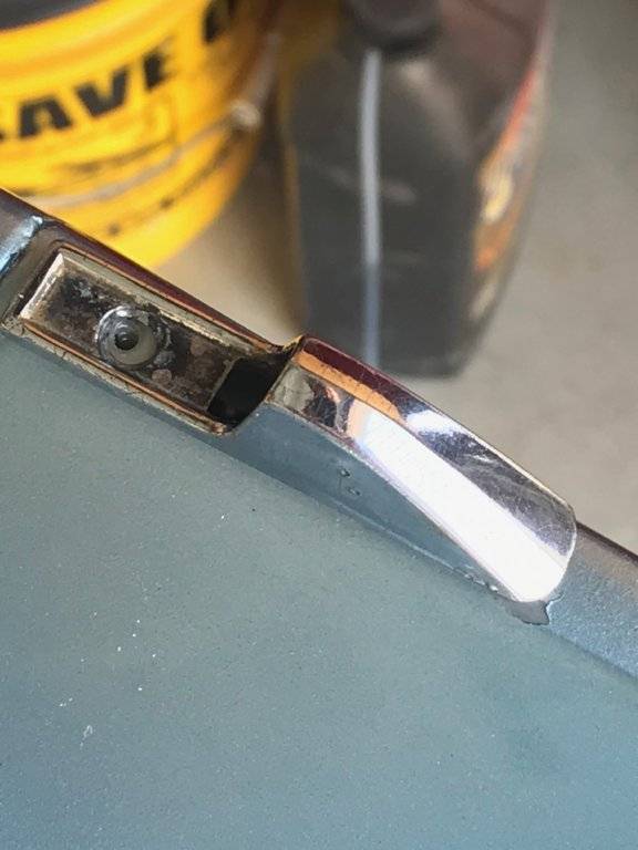

This is of the good side:
I think the original color of the insert was tan. Looks to have been hit with the paint whenever the car was redone.

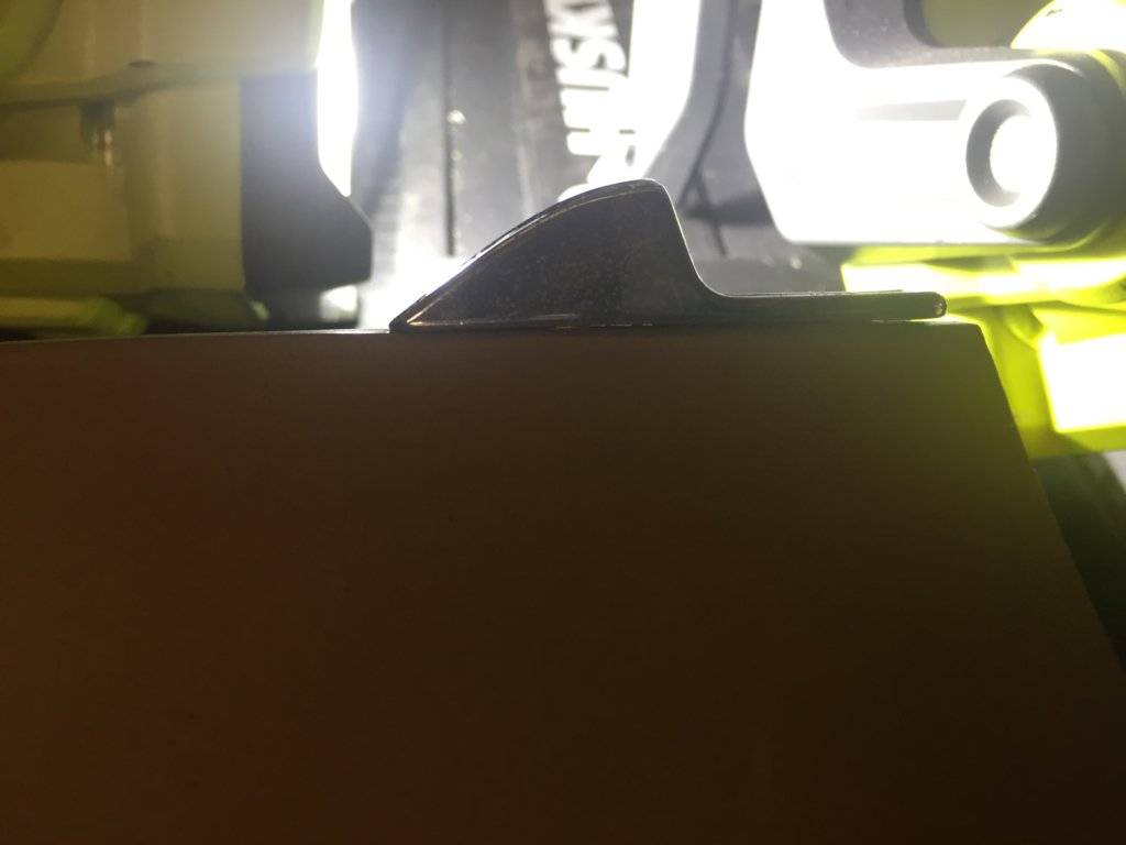

Alright... So I got the clips in yesterday and with some minor modifications they look like they are going to work out. But my next questions is about how the turn signal light are meant to stay up in the housing once they are installed.
but what I can't figure out now is how the light is suppose to stay up in the housing:
The light protrudes up through the fender into the housing, but it does not appear that there is anything there to hold it in place?
Any help here is greatly appreciated!

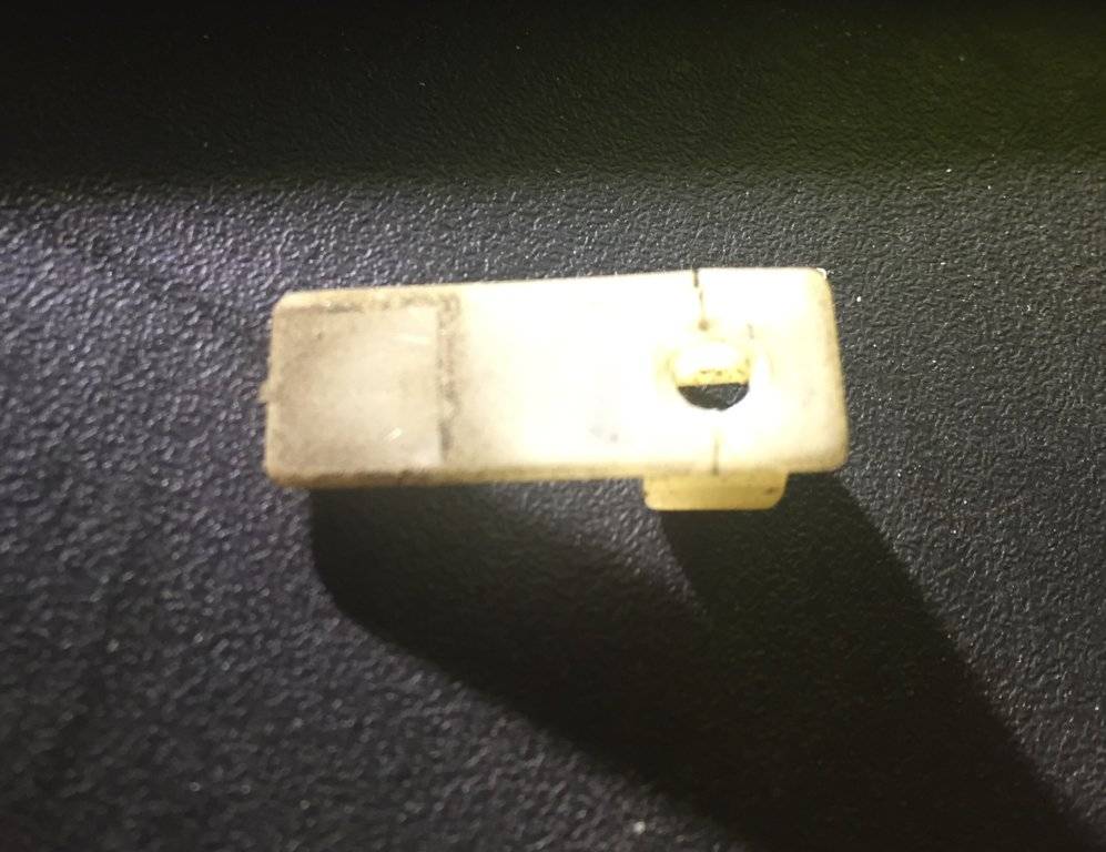

I would try modifying another clip but instead of cutting off the tap, I'd try cutting a slot into it just wide enough for the wire harness to go through so the clip would hold the amber lens into the chrome housing.
I think the clip was supposed to hold it in place. Looking at your first pic, I'd say that there are remnants of the plastic clip (the part you cut off) stuck to the fender.
Thank you for the suggestions.
The tab part of the clip had a little ridge under it not allowing the housing to sit flush on the fender. Maybe version 2.0 I’ll get rid of the ridge instead of cutting the tab completely.
The width of the tab is only slightly wider than the ‘neck’ of the fender light. There wouldn’t be much left if I try to make a fork out of it to hold the light. But I do like your thinking.

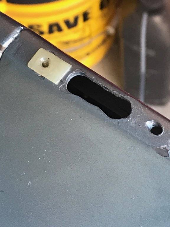

The hole on the right fender looks drilled and sawed, The hole on the left fender looks "factory" punched along with being longer and closer to the screw hole.
Bet the clip fits the left fender.

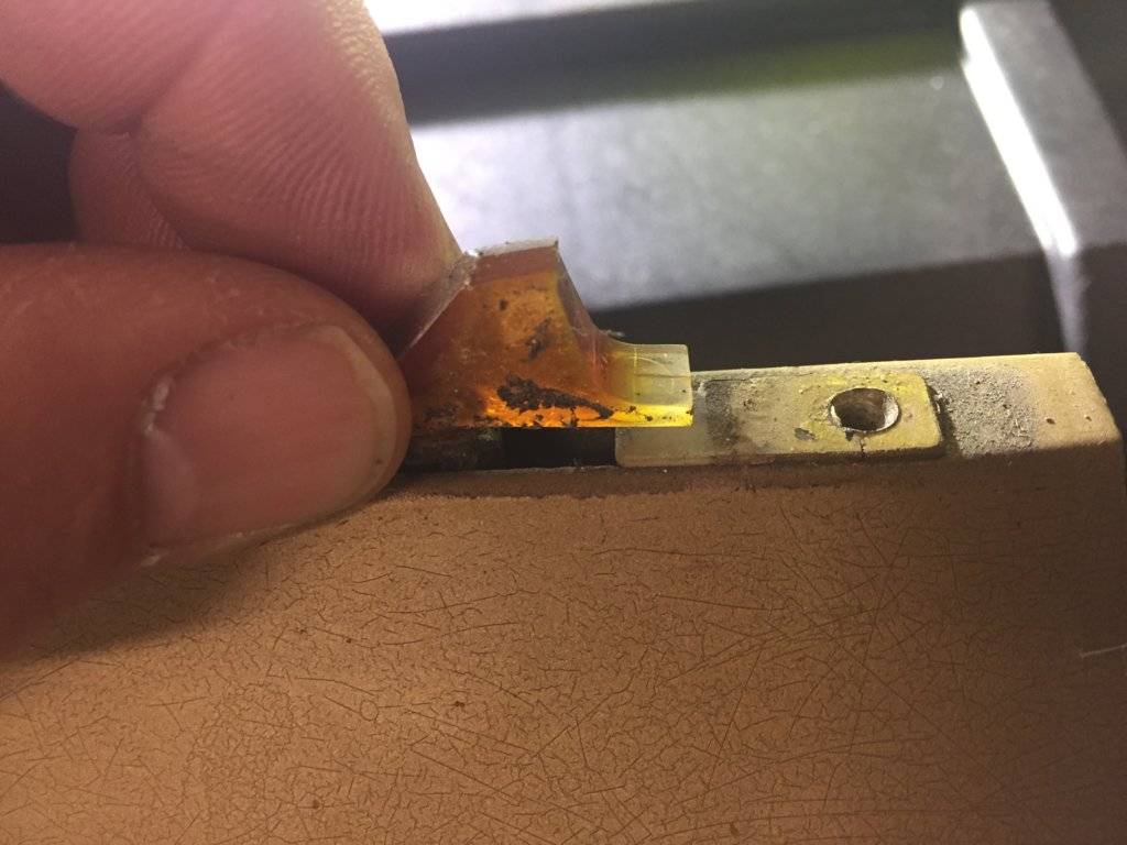

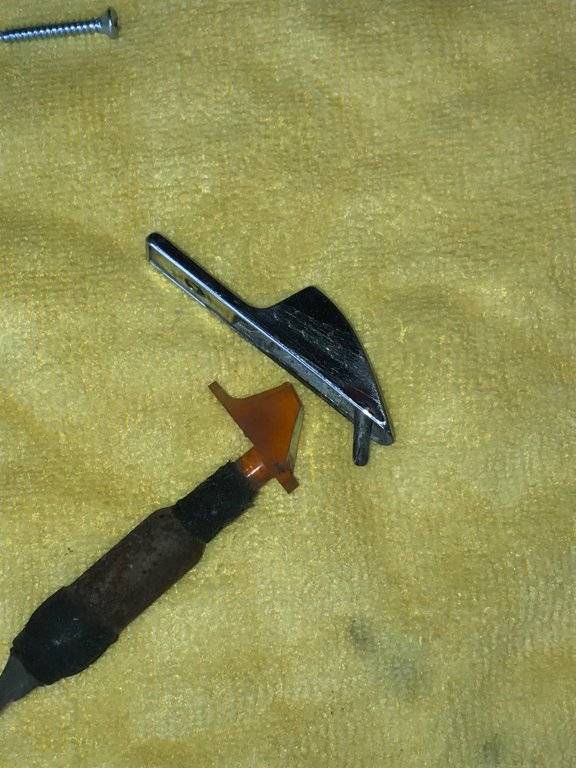

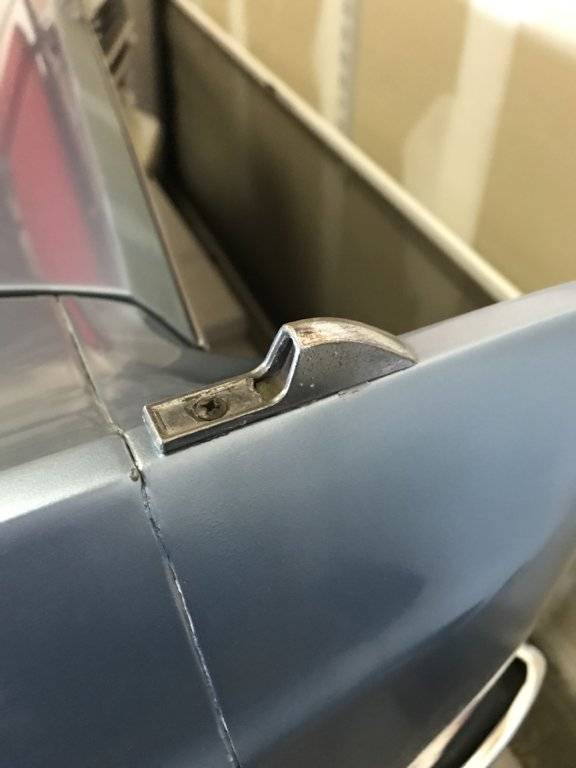

Here is the original set up and clip from a spare fender extension that I have... my intention was to send you the clips that I have to help you out, but just the process of try to CAREFULLY remove them resulted in one splitting into 2 pieces, and the other has cracks where the screw threads ( probably occurred 50 years ago!) any way here are several reference photos to help with the mystery..... and if you still want the original clips -just send me a PM with your address!
Oh BTW the chrome housings do not fit flush with the extension.... you can see light under the light assembly before I even touched the screws!
