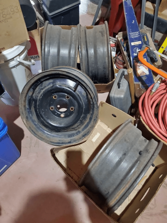

Can anyone tell me if these are Mopar 15 x 6 wheels, and if so, would the bolt pattern be 4.5"?

When the center hole is not round that seems like GM wheel. Mopar didn't use that.

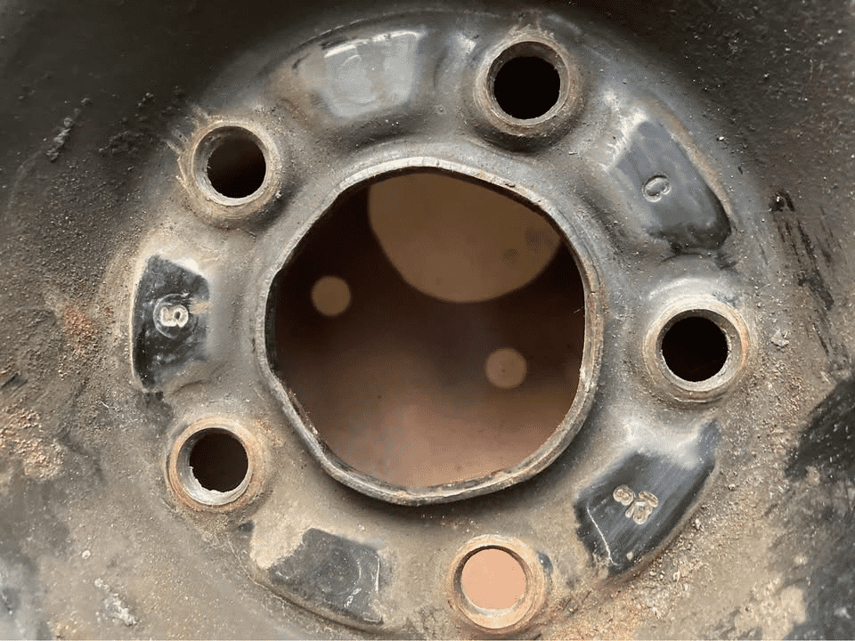

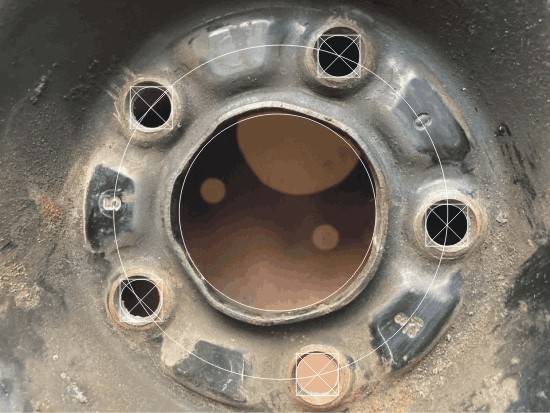

Using some image analysis, if those are 1/2 inch stud holes, then it looks like a 4 inch bolt circle, with 2.34 inch center hole.
Try that again, using a 5/8" hole. The lug holes for a 1/2" stud has to be larger than 1/2".
If it was a 4" BC Mopar wheel, it would be 7/16" studs and yes, a 1/2" hole would be about right, but I've never seen a 15" Mopar wheel with a 4" BC, although anything is possible.
Cragar shows a Series 08/61 S/S wheel (1526461402B) in size 15x7 with 5 x 4.0 bolt pattern.
If the lug holes are 5/8, then the bolt circle becomes 5 inch (4.96 so close enough to 5).

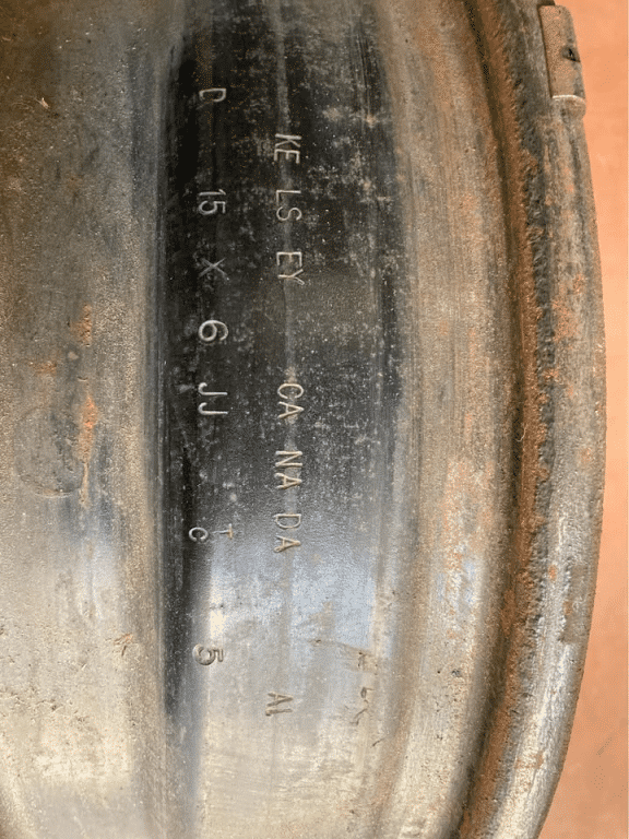

Yes, but that is a stock type Kelsey Hayes wheel. You can get an aftermarket Cragar SS or similar, but honestly, even those are kind of rare to see.
A 5"BC would make sense with the GM type center hole.
The thing that looks strange to me is the diameter of the hubcap retention ring (and nubs) compared to the outer edge of the wheel's outer edge. Which might mean a Ford wheel for a 1970-era Torino? Which could well mean the 5x4.5" bolt pattern but with a slightly smaller center hole diameter, as Ford's was a slight bit smaller than Chrysler's center hole diameter.f
GM wheels have a 5x4.75" bolt circle, so "no fitteee". Nor did GM wheels have such a large hubcap retention ring (and nubs).
Many times, if the wheel was an OEM wheel, it would have the corporate logo stamped into it somewhere near where the rim specs were stamped on the inner, middle, rim area. Pentastar for Chrysler, Ford Oval for Ford. Even Magnum 500s.
GM factory wheels has a letter code, stamped in all caps, near the valve stem. That code was used in the parts books for valid ID of wheel width and related applications. ALL OEMs used stamp codes near the valve stem. The difference was that if the codes meant something as to what the wheel was used on AND had parts book designations listed.
Of course, now I feel an overwhelming need to measure the lug hole diameter on my 4 1/2" and 4" BC Mopar wheels.
I just measured a 4" BC and a 4 1/2" BC wheels. 9/16" for both, which really surprised me as the 4" BC uses a 7/16" lug nut.
So @MoPar~Man , the magic number would be 9/16" rather than 5/8".

To complicate matters, there are 2 different styles of wheels pictured.
The back shot is not of the wheel with the face shot.
Good thing... The spare was soft in the Barracuda and I had forgotten to check it this spring!
If the hole is 9/16, then the BC is 4.45 inches. So maybe these are 4.5 BC wheels?
Did Kelsey-Hayes even make wheels for GM. I thought only FoMoCo and ChryCo were the only big three manufacturers that used them
Hollander use to publish a Wheel Guide. I had a 1970 dated guide but in moves over the years it has disappeared. With the id numbers you have you should be able to identify using that publication. I'm sure they are available on Ebay or maybe someone here has one.
