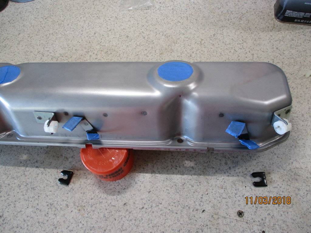

You'll recall my post here New valve covers from AMD. Quite nice! about my AMD valve covers, but as I mentioned, I'm moving to 8mm wires. This doesn't quite work with the OEM "rubbers" on the right side, so I hollowed-out [to 29/64ths] the brackets for the white plastic insulators (which then need to be drilled to 19/64ths for 8mm wire):
For the left side, I stole an idea from this picture of one of YOUR cars from Carlisle:
So, using the readily available repro brackets for the # 7 or #8 wires, I cut off the bolt hole tab and JB Welded the bracket to the valve cover in similar locations. I even ground a little angle cut on the corner of the tab so it would look "proper-ish". How silly am I?
Anyhoo, I HATE for plug wires to touch anything except the distrib or the plugs, so I don't care if you guys deduct "style points" for my non-OEM mods! :D
Time for paint!
Oh, I'll mention it again--the AMD covers are lovely, but they come out of the box DIRTY with fabrication shavings and crud. Who knows what lurks behind the interior baffles? I blasted them dead-clean with soapy water, paintbrush and hose.

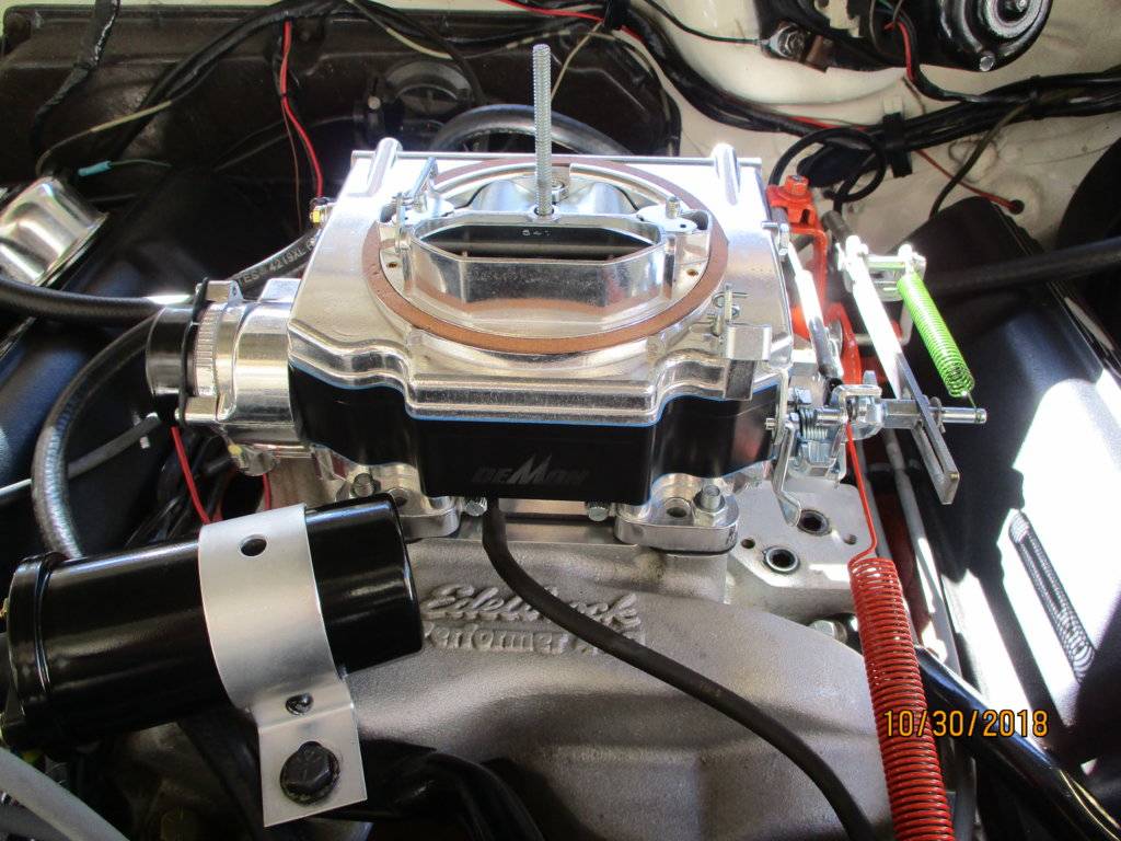

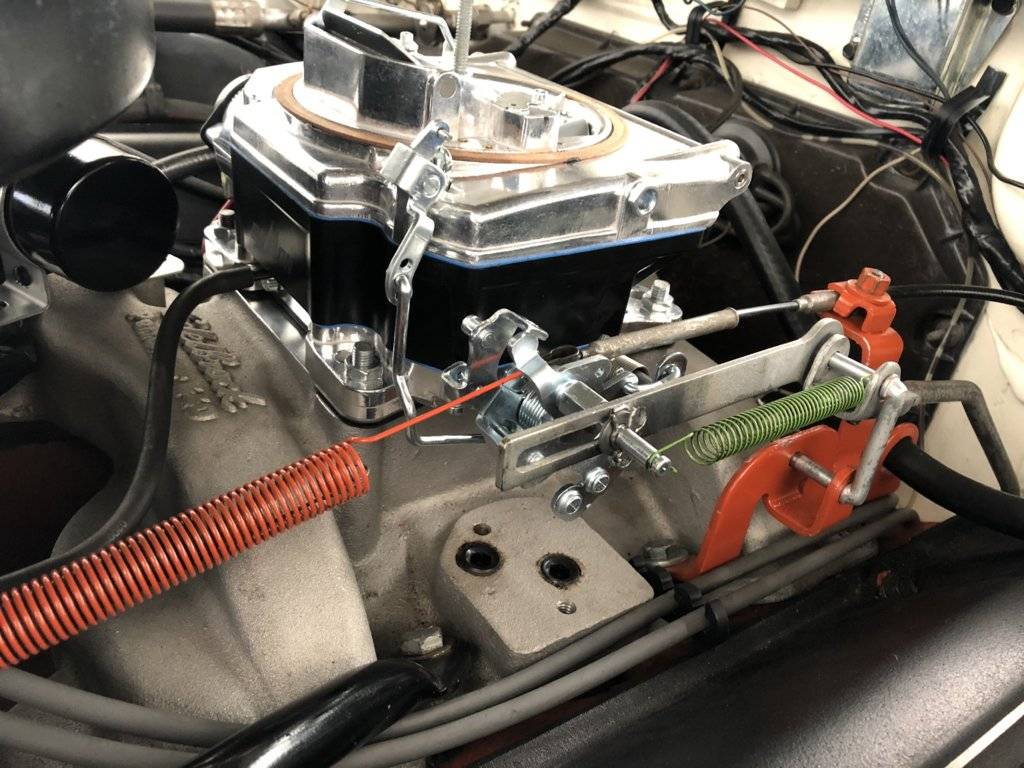

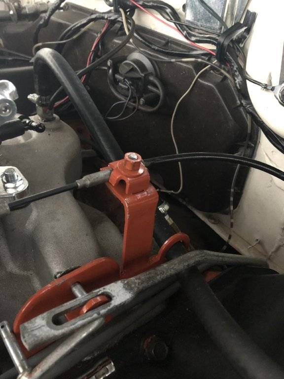

For instance, I had to raise the throttle bracket about 1.5 inches to get proper alignment with the Demon carb on the tall Performer 440, and mod the kickdown slot for full tranny pressure at WOT.
But when it's all put together with the air cleaner in place, it will pass muster to the untrained eye. Wait...is that a Mopar ThermoQuad we see in there? No.....it's just a Demon. :p
And that throttle return spring? I "think" it's supposed to be a grey or plain item (which I have in a repop), but I prefer the orange B-body spring. And the red wire to the choke will also be gone soon....Back in Black! And steel fuel line will soon feed the carb, once my AMD valve covers are on. The MoPerf items are too tall at the front corner for the line to fit and scoot past the dizzy.

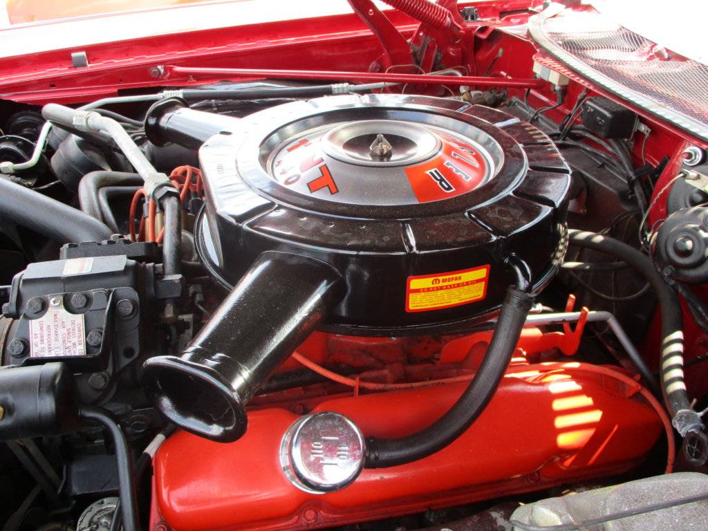

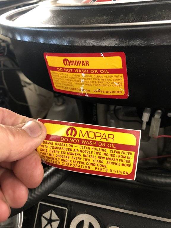

And finally, here's another "silly" thing I decided to do. After buying a very expensive eBay dual snorkel air cleaner that was in pretty good condition (needing fresh paint, pie tin, new vacuum and breather hoses [but NOT friggin' heater hose...the correct hose!], etc), I decided to carefully remove and replace the original filter sticker with the slight damage markings and slightly crooked placement vs. the "too new" looking repop item. How silly!! How Vain!!
