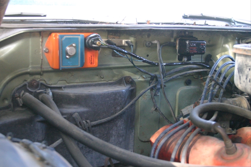

You can't beat the factory electronic ignition module and distributor for a street car, parts are available overnight at you local parts store. Total cost for me was $100.
