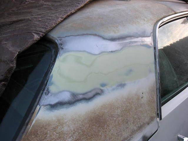

I started on the worst and hardest part first. Apparently this car got a new roof sometime in it's life. I have suspected major work since I got it. The body filler was all cracked. I see why. There was about 4" that weren't welded. I'll have it primed tomorrow.

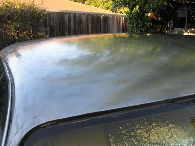

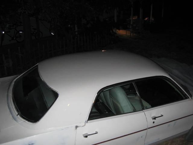

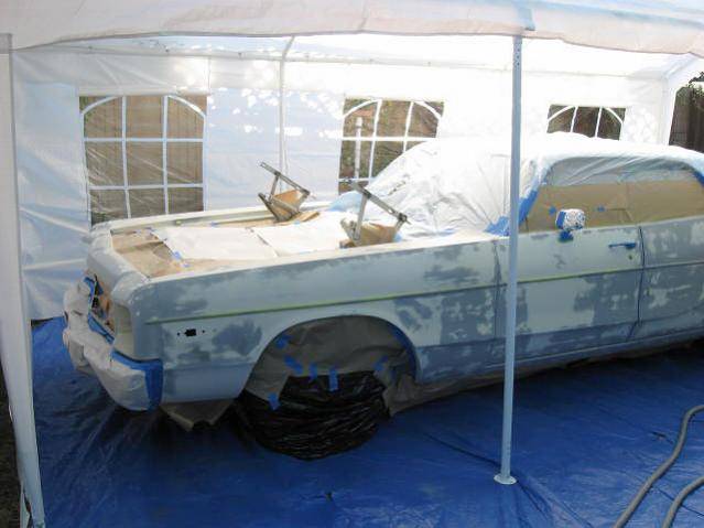

Was jumping between 3 projects today and got a late start. Bit I was able to get the flat done. Tomorrow I'll tackle the main part. I'll have the rear window removed to do the channel and the rot below the separation molding. It will take longer to strip that channel than to do the whole roof!
The wind kept tearing my masking. I finally got fed up. I'll just 00 steel wool the back window to get the over spray off.
Looks familiar, however, instead of any rot just 4 pinhead pinholes to be sealed up. Going cheap by using filler instead of lead is what eventually leads to this. That trough for the lower rear window channel is made to order for pooling water and all kinds of loose debris in any Fusie car. Solved both those issues for good.

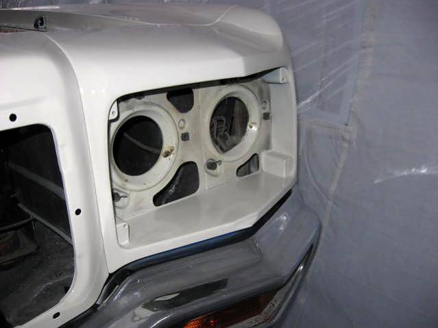

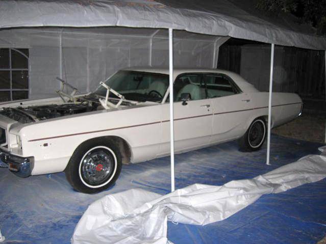

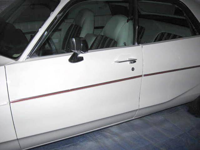

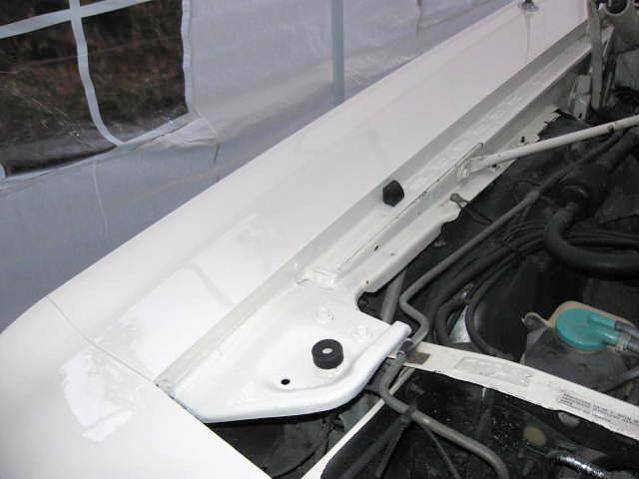

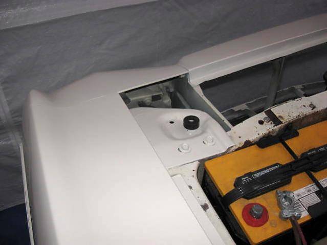

Did the painting today. Temperature under the cover of 85 degrees. Wind was dead calm. Used PPG Concept Single Stage and split my reducer between their warm and hot. Had 1 gallon of paint and used only 3 quarts of it to paint the entire car with 3 coats. My HVLP 4 stage turbine doesn't waste paint. Tried a little difference this time. When I spray small sections like jambs I have the fan set tight and my volume out 4 turns. This always lays down nicely. With a larger fan I always got some OP with the volume up a little. So I adjusted the volume all the way out till it hit the handle and then turned back in a little.
Started at the top front fender and all went well. When I hit the driver's door I must have been moving a my slower pace from previous experience and I could see runs forming within 2 minutes of laying down the paint. All the runs are just below the body line on the two doors. The 2nd and 3rd coats went fine as I picked up my speed some. Must be 30 of them. Well shave them off, sand level with maybe 600, then 1500 clear coat disc. Was going to go over the car with a clear coat disc anyway so this is an extra step. With 3 coats I have room to play with in color sanding. This is what I'll be doing on Wednesday.
Here are some quick pics as the sun was going down. Oh, the paint was dry in 4 hours due to the 85 degrees. At 70 degrees it would have been 6-8 hours but a 10 degree increase will cut that time in half. Good and bad since pot life is cut in half also.

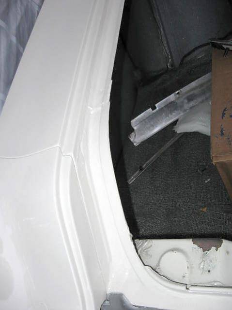

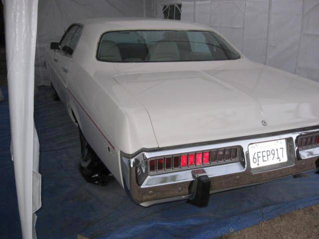

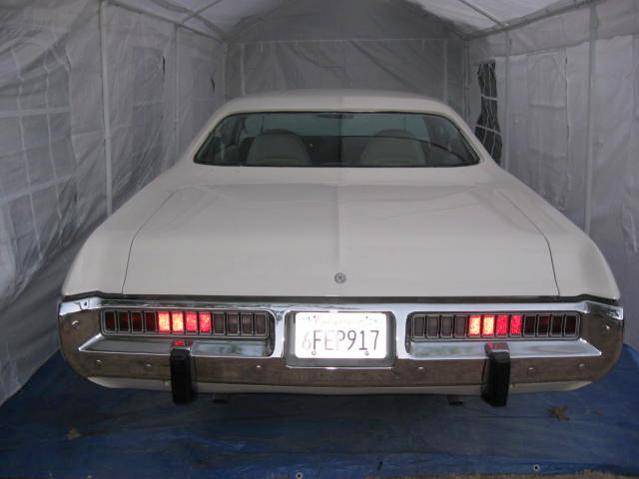

I had the back glass taken out today and rush home to get started on the channel. Didn't know what I was getting into. Turned out to be not as bad as I expected, the holes were no bigger than the last time. But they were leaking water in the trunk. I found out the hard way when I laid in there to remove the molding strip. Which is still on. Heh
After grinding everything to bare metal, treated it with rust converter, sanded it again, applied some etching primer, let it cure, and put some All Metal in the channel. Realizing its all fiberglass and aluminum I decided I would coat the whole lower track with it and create a plastic bowl so to speak. Once I get the sealer primer on there, scuff that up and paint it, I doubt this will ever happen again. Unfortunately, I forgot to take a pic of the before. I went in to get the camera and forgot why I went in. Sat and watched TV instead.

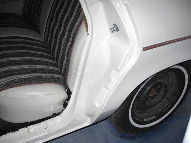

After the last picture I finished the feathering, and re-shot the etching primer. It cures quickly so I put in all new molding clips. Just as I was starting to clean up, ie. blow out the interior, we got another down pour. I managed to get the cover on the car before it got too bad. But now I have to wash everything inside.
I'll get into this next. Once this is done, everything will go quick. This damage is from the top as well. Similar damage on the other side, but not as bad. Rusted from the outside in.
