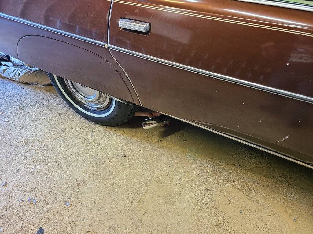

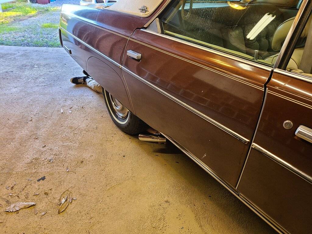

We finally received the headers in the mail, and are now pretty much ready to have the exhaust put in. However, I have to make a pretty critical decision, and I am stuck between two options. I could either run the exhaust out the side (1 pipe per side), like the image below displays, or I could run the exhaust out the back with the end of the pipes being hidden and not visible under the bumper (kind of what the stock single pipe looked like). For context, I purchased an exhaust tip at Advance and fitted it up to see what it would look like. Both choices would use true dual pipes with no mufflers and one spun catalytic converter per pipe. Let me know what you all think in the poll.

IMO, on a car of that type, don't do anything to detract from its character/dignity. To me, even visible chrome tips at the rear bumper look out-of-place on this type of car. It is not a hotrod and never will be (that's not what this car was born to be).
I would also suggest not to make it too loud, but that seems to be the direction you are headed with no mufflers?
What is the purpose of having only cats, and where are they going to be located? What will your pipe diameters be front-rear?
But ultimately, it's your car, and you should do what makes you happy.

FWIW, when I see side-exit exhaust rather than the factory rear exits (except on AAR and T/A E-bodies, where they were like that from the factory), it sends messages as to whether or not the vehicle's owner really understands the car AND has the funds to do it right. Sorry if that might offend, just my observations over the years. Your car, your money, your dreams.

That's gonna be tough, driving and having someone hold your tips as you drive! Painful, I can imagine. And a wee awkward. Especially when backing! LOL!
In my opinion, if you are going to put the exhaust out the side do it behind the wheel and tire on the quarters near the rear bumper

First, and I know you don't want my opinion, headers and whatnot are a major detraction from what is otherwise an very nice Luxo-Barge...
Second, from a safety standpoint, the exhaust MUST exit behind any movable glass. You just don't have enough space in front of the tire, and out the side behind the wheel is silly... the whole point of out the side for a sedan is to cheap out on the bump over the axle. Wagons go out the side due to the movable back glass.

I agree about the chrome tips under the rear bumper, which I see quite a lot and am not a huge fan of. I am not planning on having it be crazy loud, but it currently only has a cat on it right now since the rest of the exhaust rusted off, so I wanted to keep the sound it has now. The cats will likely be located in the middle of the car to give some space after the headers. The pipes will start at 3 inches since that is the size of the header collector and will be reduced to 2.25 inches and have that size for the majority of the pipe.

Alright, thank you to everyone for your input, I think I will likely run it out the back, but not visible under the bumper, as you all brought up some good points. Once the exhaust is put in, I will let you all see (and hear) the results. I also plan on getting the car dynoed soon so I can have a baseline number before any performance, so I am excited to let you know the results. This will be before the headers are put in.
