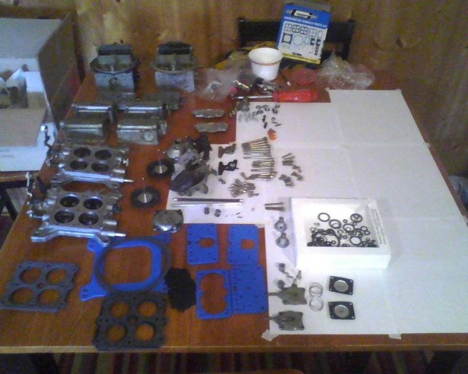

I've done it with two holley 450's. The carbs have to be tuned for duel quads. Out of the box the jets and springs for the secondary's are off. I also ran it with both carbs working at the same time and progressive linkage. After I got everything dialed in I liked it better with both carbs working at the same time vs progressive. Progressive was easier to tune.
I tried with two stock AFB's and I could never get it to run correctly at higher RPM. The drawback with the edelbrock's/AVB's is you are limited on secondary tuning, or maybe it was just me.

It worked but you need to define "fine". Did it work as well as a correct size single 4. Probably not. It was very streetable and looked cool.
I worked for hours getting it dialed in to work at idle, mid-range and wide open. Changing jets, pump shot, secondary springs. I wish I would have written down the final specs.
