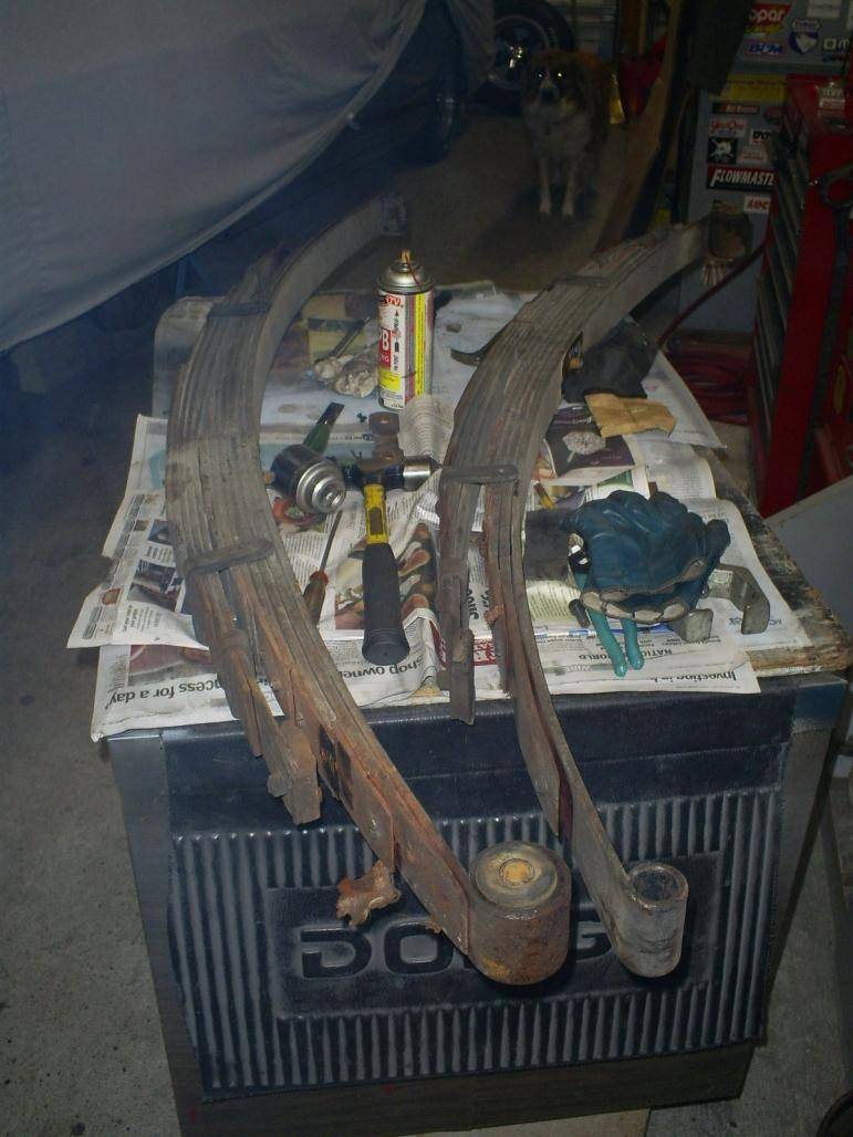

Got the springs out ( 85.4 lbs each! ); rear hanger bushings were toast, front bushings not too bad but I'll replace them if I can find new.
There is no center bolt thru the leafs, I can't figure out what is holding them together... Smooth top & bottom other than the alignment pin for the axle. Any spring experts here with ideas?
Somebody upgraded those springs.Typically the bands would keep them together.
With soo many leafs,the center pin will not keep them together.
The mains are probably toast.

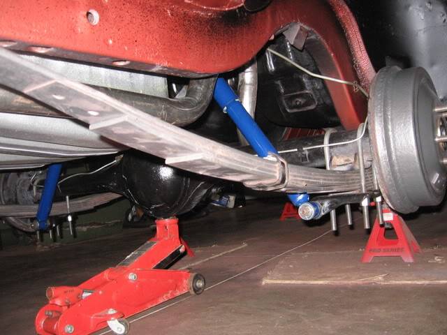

In your pic on the firt page you can see that the righ spring was rubbiong the frame rail just behind the front eyelet.

I wondered about them being updated, but everything appears to have been in place since new. I bought the car 22 years ago from a guy that grew up with the original owners son who bought the car specifically to pull his Airstream trailer. The factory trailer towing brochure is still with the car and mentions heavy duty springs as part of the package. There is no signs that they ever had bands around the main section of leafs; and in the last pic you can see the canvas/cloth hanging out of the pass spring that was rubbing the frame in the first pic. The cloth pieces are what I'm looking to replace as the spring are squeeking from them rubbing together.

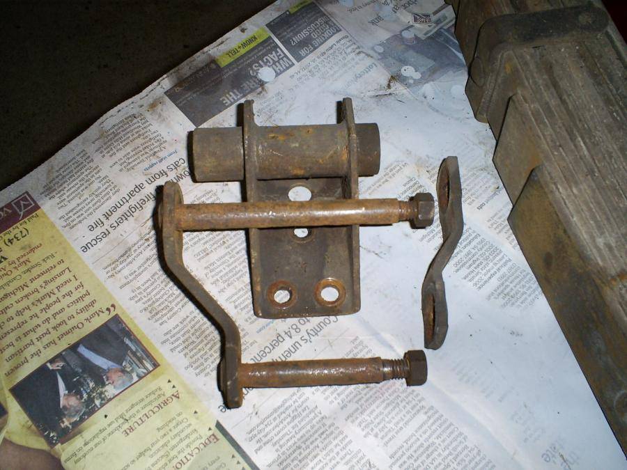

The rear hangers don't appear to be the same as b body pieces, I will look at my Chargers setup to confirm.

Checked & the rear hangers are different than the b body, also different than my '66 so maybe a wagon thing? The bushings I believe are the same but the top long one has a center bushing, 3 pieces total.

Those spring shackles are not in reproduction,and there are some NOS ones floating out there.
As I mentioned,take your parts down to a local truck and/or spring shop.Thay might have the bushings for them.

I would also guess dealer installed; whoever put them in it was the complete spring pack as there is no apparent way to seperate them! The shackles are in decent shape & will be reused.
