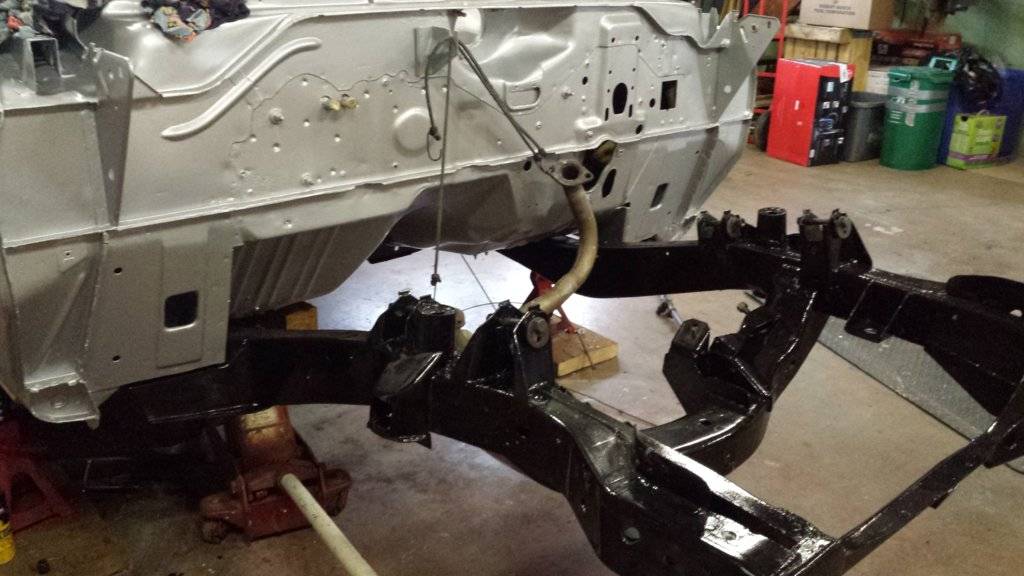

I liked the Rust Bullet product.
Easy to work with
Lots of time to work it into the metal
The can can resealed with the inert spray gas(Bloxygen) you can buy to preserve the opened product.
The gloss black is tough as nails too
I used the silver on the firewall & both silver & silver then gloss black on the stub frame as shown here.

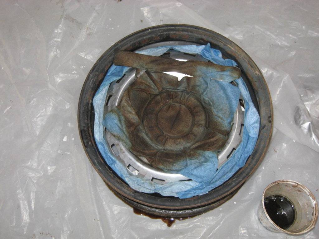

I got this strut arm from Mr. Murray Park. Covered it with blue shop towels, stuck it in a trash bag, and inundated the towels with vinegar. I wrapped up the trash bag and let it set about 48 hours, then removed the wrap.
I took a piece of balled up aluminum foil and rubbed the part down. then rinsed and dried it.
The results are shown below. The shiny areas were wire brushed using a drill press.
There's obvious pitting, but any rust encapsulator will need a rough surface to adhere. Personally I believe the results were impressive!
I'm looking forward to using vinegar on the floor to get rid of the rust and prevailing musty odor as well.
