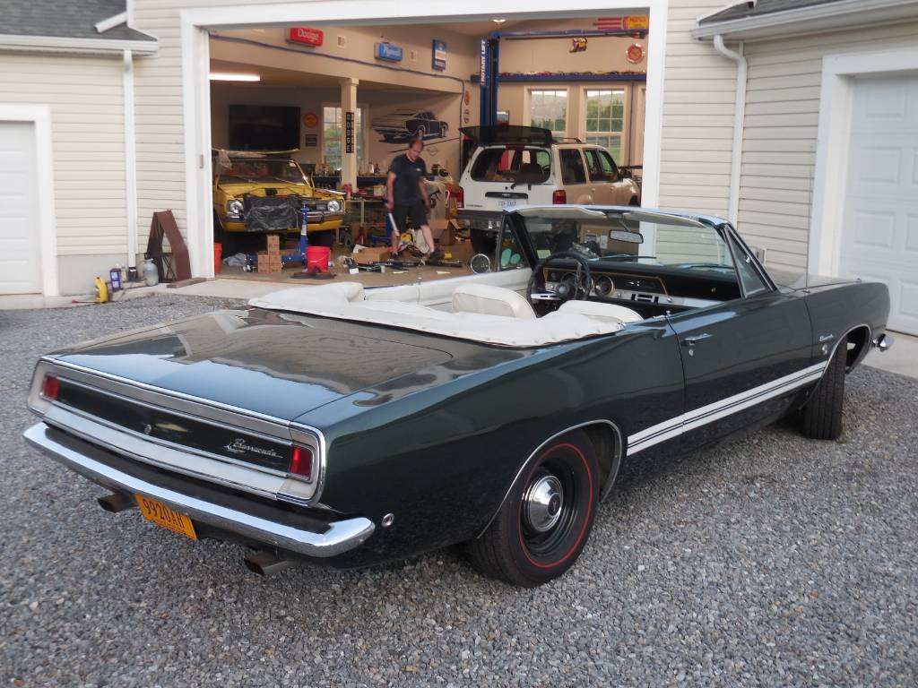

Diamondback III radials on my 68 Charger and 68 Barracuda (also available as white walls, blue streak, and gold streak).

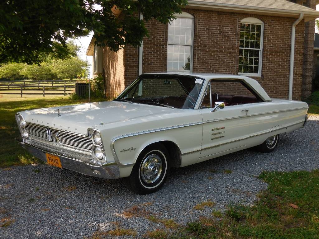

On my 66 Sport Fury, I have realatively cheap Hankook white wall radials, and have no complaints.
Hankook Optima whitewall radials on my 66 Fury. (Optima whitewalls may be discontinued, but there is now the Kinergy series white walls by Hankook).
