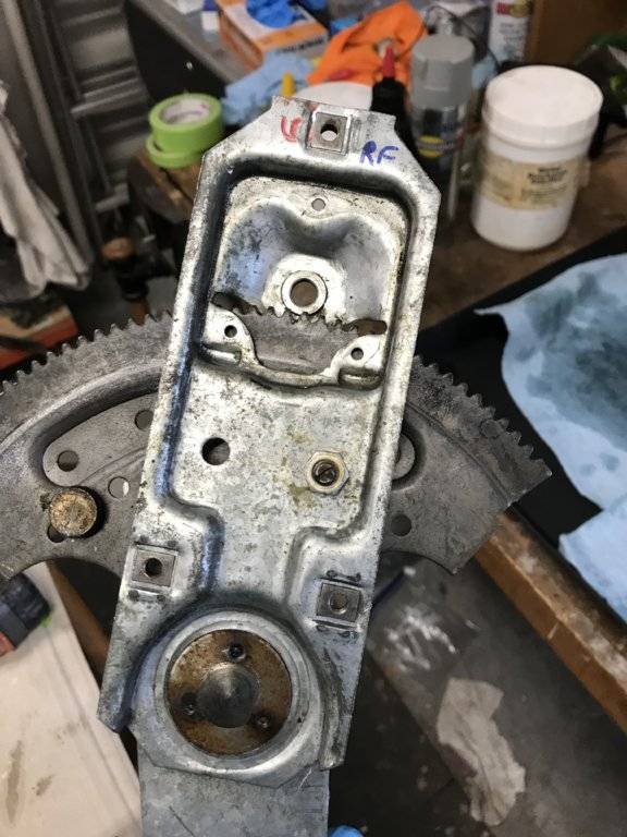

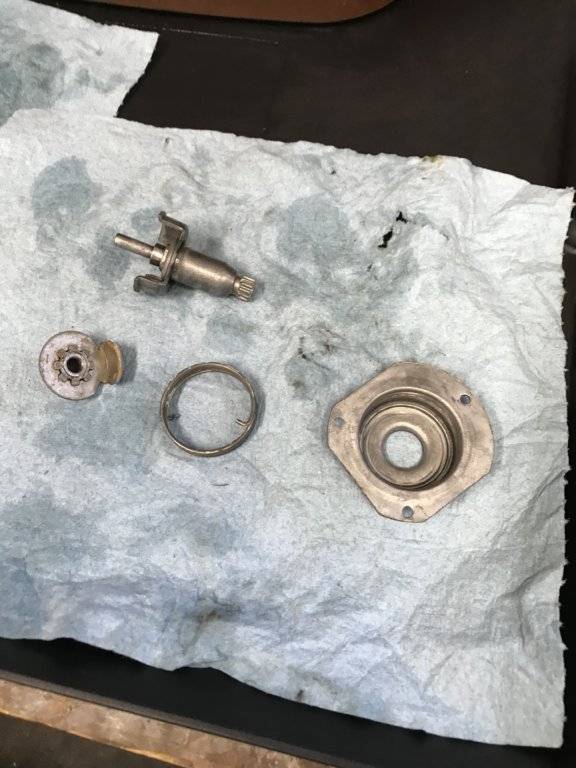

The winder mechanism has a little “braking system” in them. Sometimes it will feel like it is slipping, but is The braking system catching and releasing due to the old gunk and grease in them.

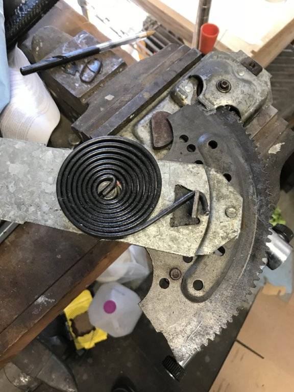

First step is to remove the large winding springs. Be careful as they pack a lot of power. I used a vice and very large water pump pliers (channelocks) and a pry to slowly unwind. I would use the prybar as a stop if the pliers were to slip. After the spring is removed you can drill out the rivets remove the housing, check for bad teeth and clean up the housing/ braking system.
