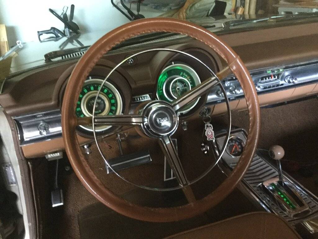

I just replaced my dash lights while a had the dash apart. The old lights barely lit the dials at night. Never were as bright as todays cars. This shows the leds at the brightest dimmer setting in daylight.
My two gauge pods come out from the front for access to lights.
The factory service manual will describe replacement procedure and list bulb sizes.

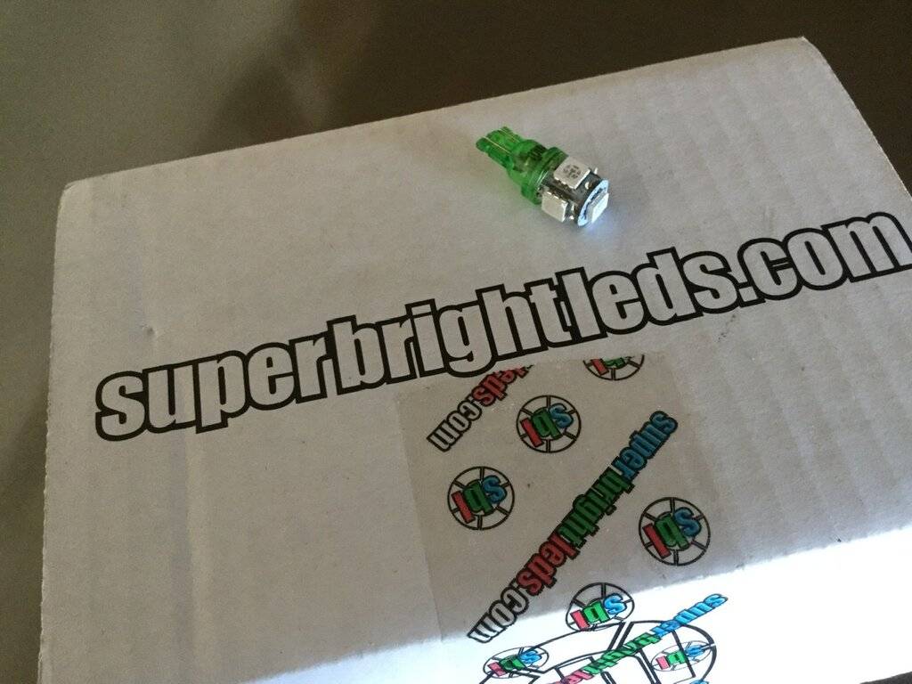

Buy quality leds and be sure to get full coverage leds. Note the diodes all four sides and top. These are dimmable and work with the dash switch. Superbrightleds has a great website with full range of colors available, various plug types and cross reference info.

Were these plug and play? Which bulbs did you get?
Yes.
My car uses both the push-in and the two pin bayonet type sockets.
The only change I had to make was to the console light wiring. Apparently leds are polarity sensitive. Had to reverse wiring at that connector.
