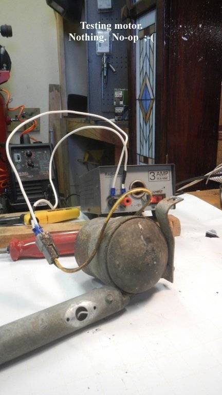

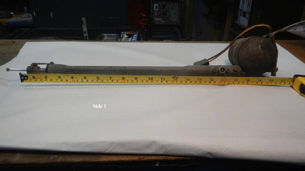

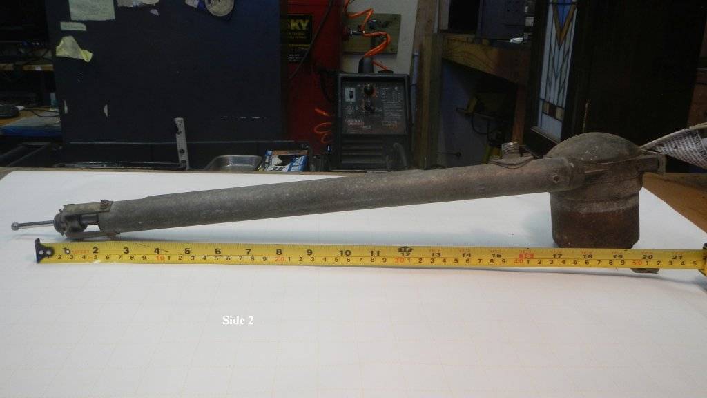

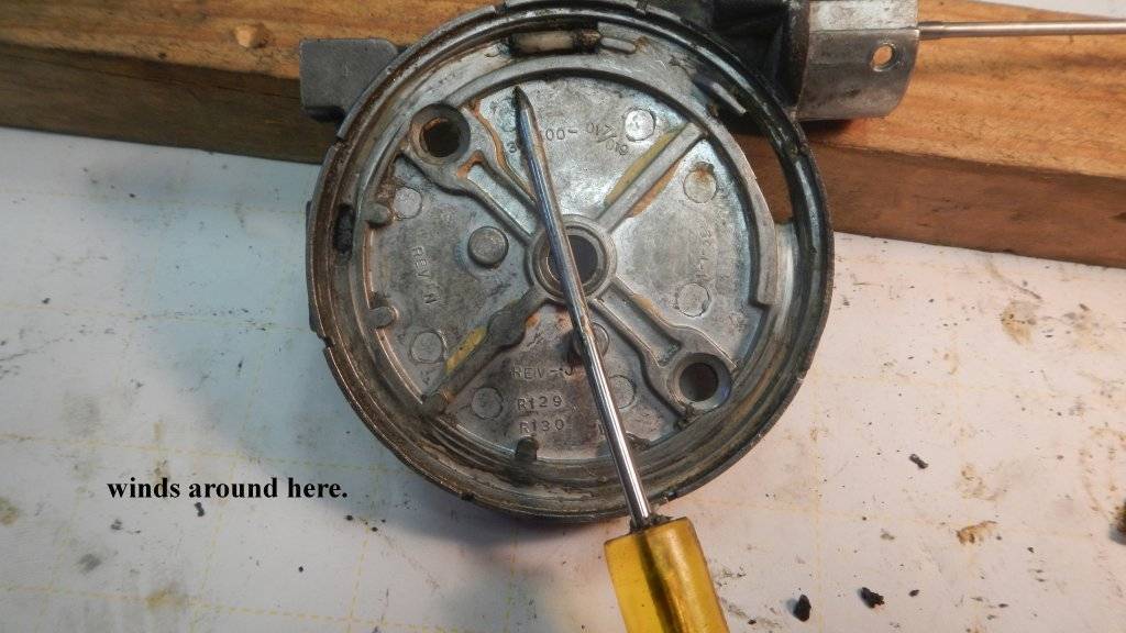

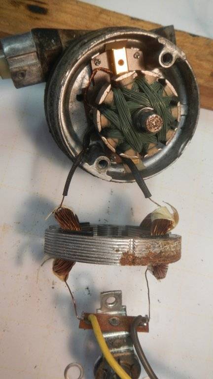

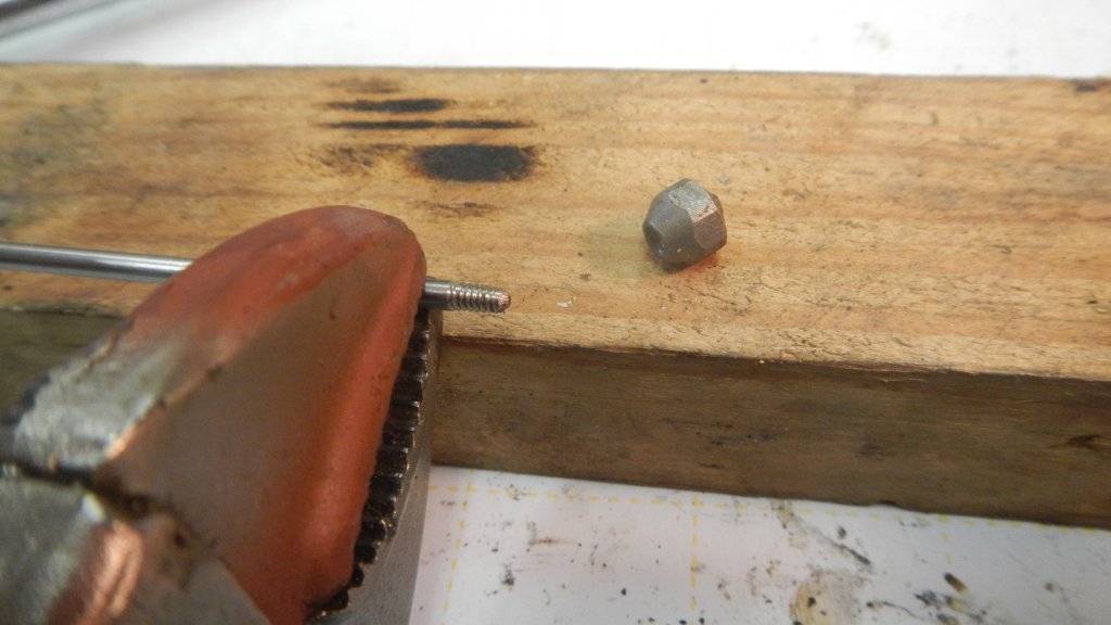

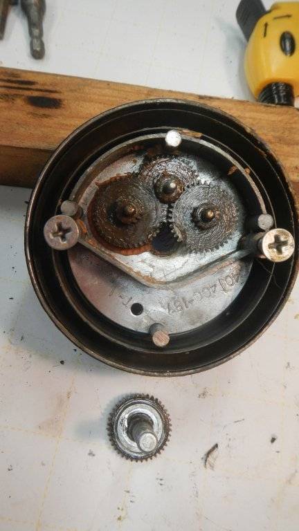

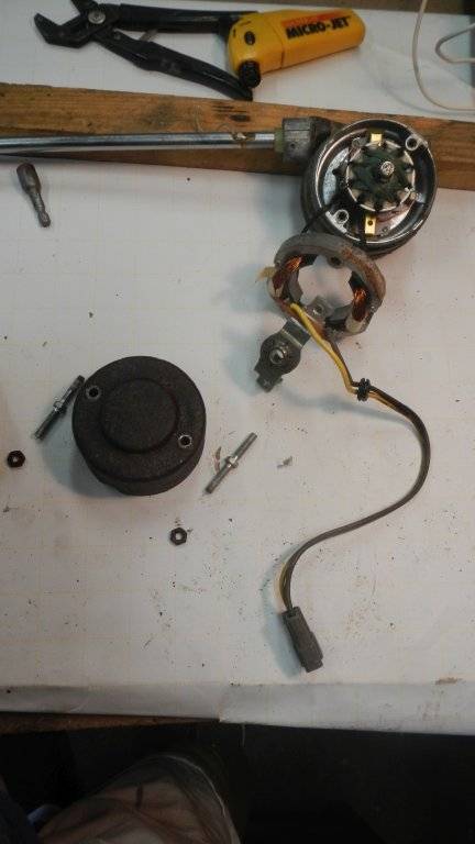

I am looking for a power antenna for my '76 NYB.
Big-John was gracious enough to send me a power antenna for a Formal he had laying around.
Thank you, John!

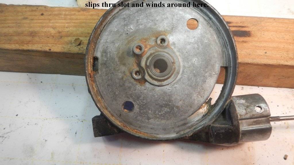

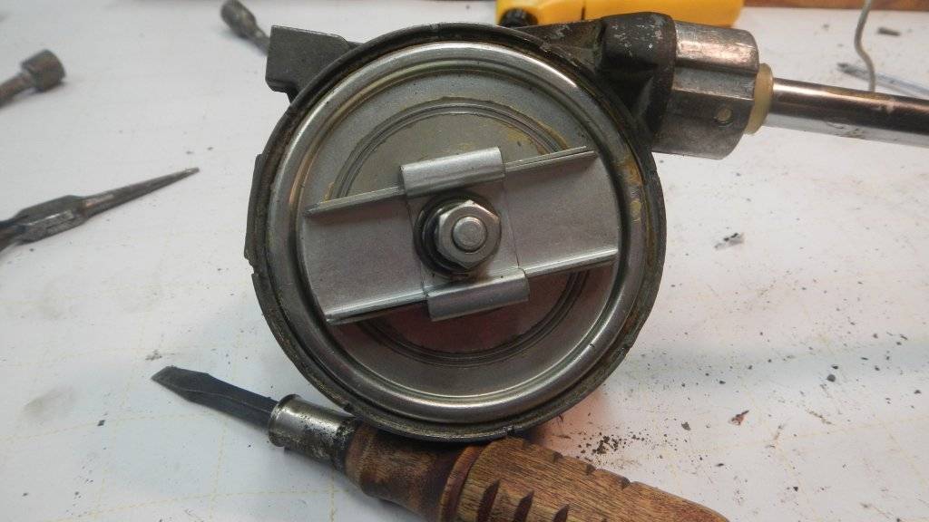

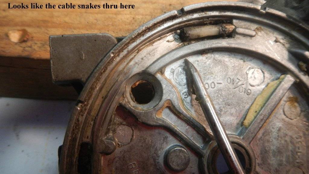

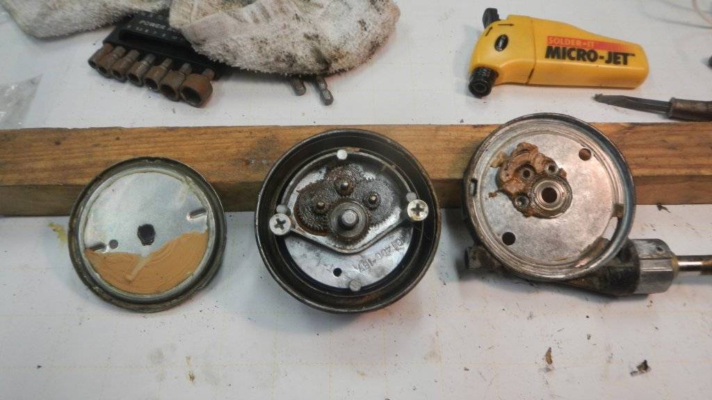

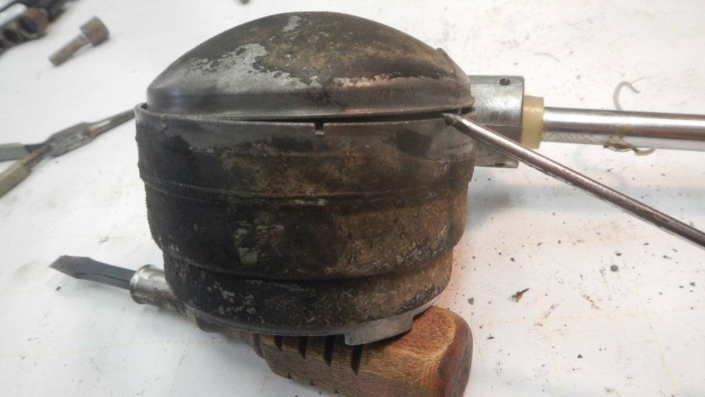

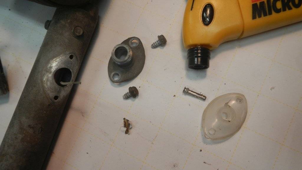

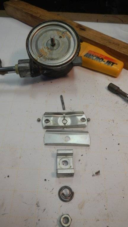

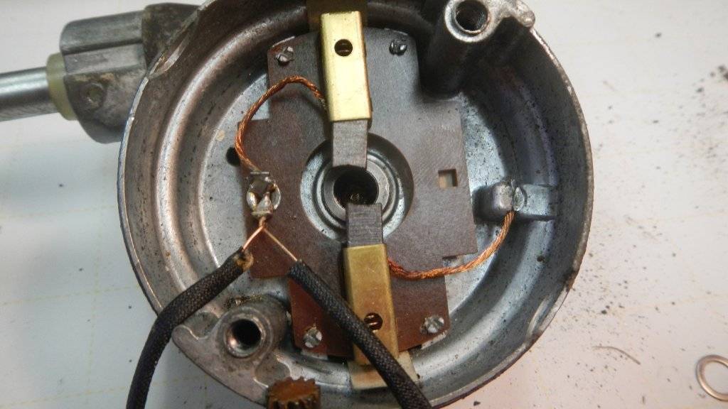

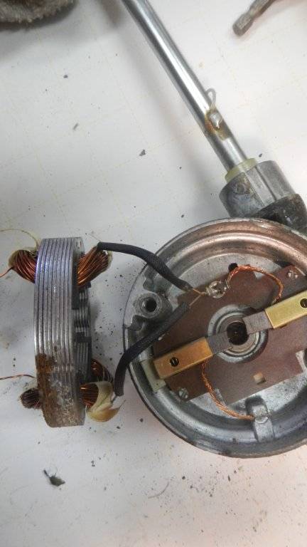

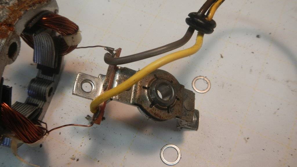

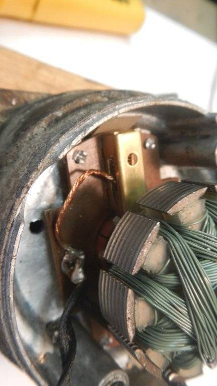

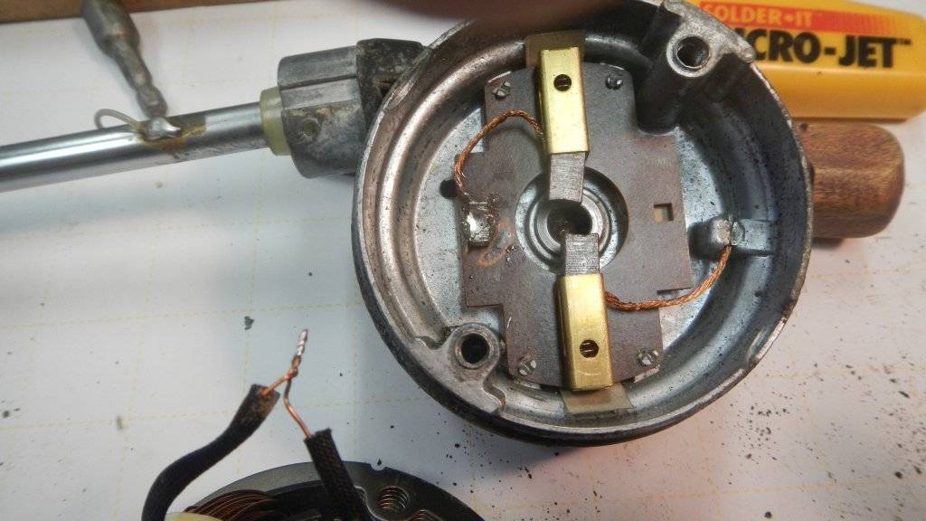

Having nothing to lose seeing as it was not working, I decided to do a Julian and take it apart and see what's going internally to see if I can restore it.
After the pics showing the disassembly, the problem will be obvious.
More next post...

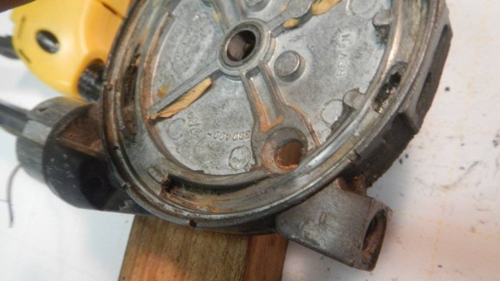

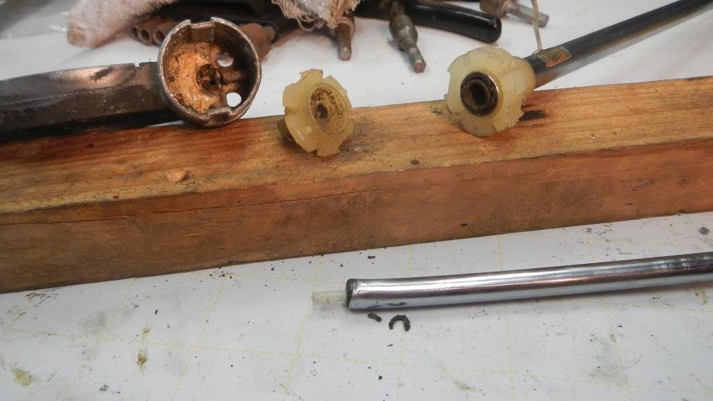

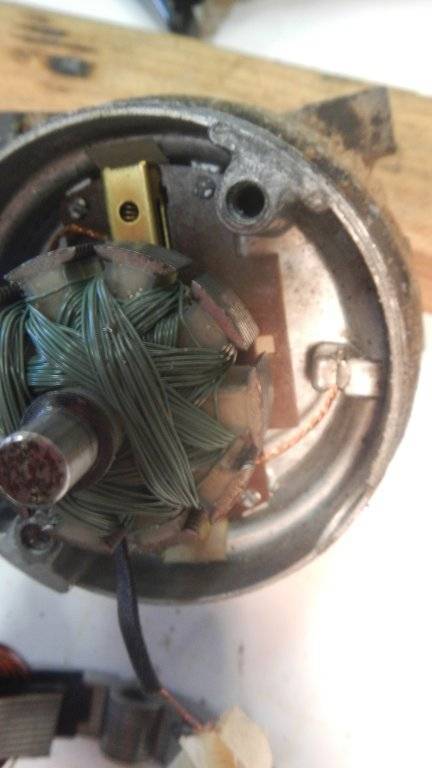

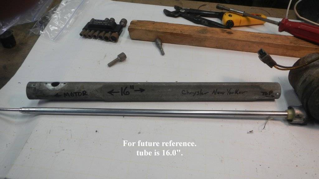

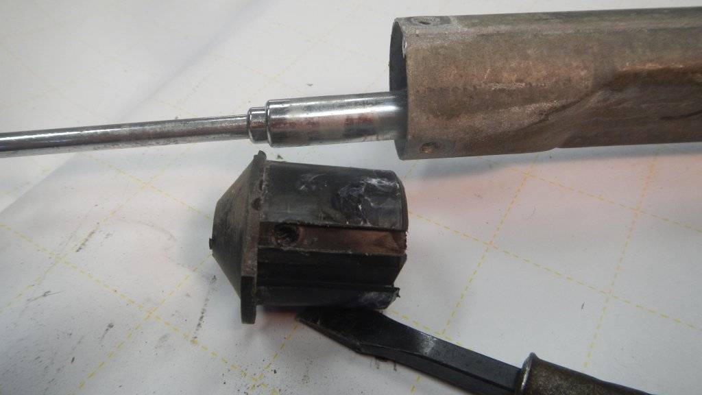

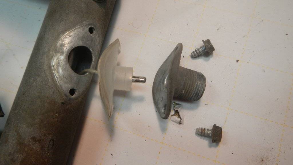

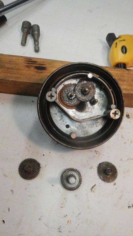

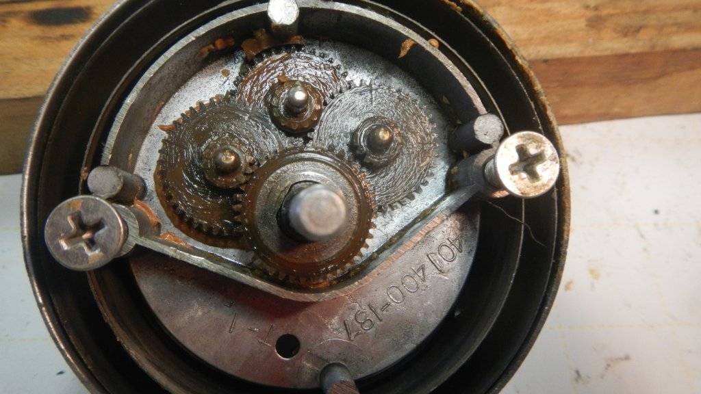

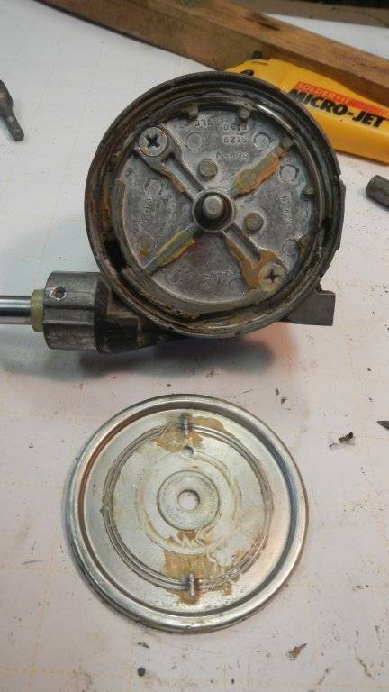

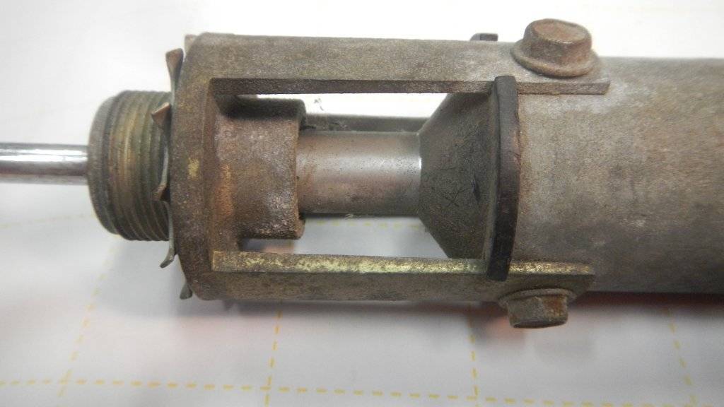

So what happened to the cable ?? This motor looks like it has never been opened.

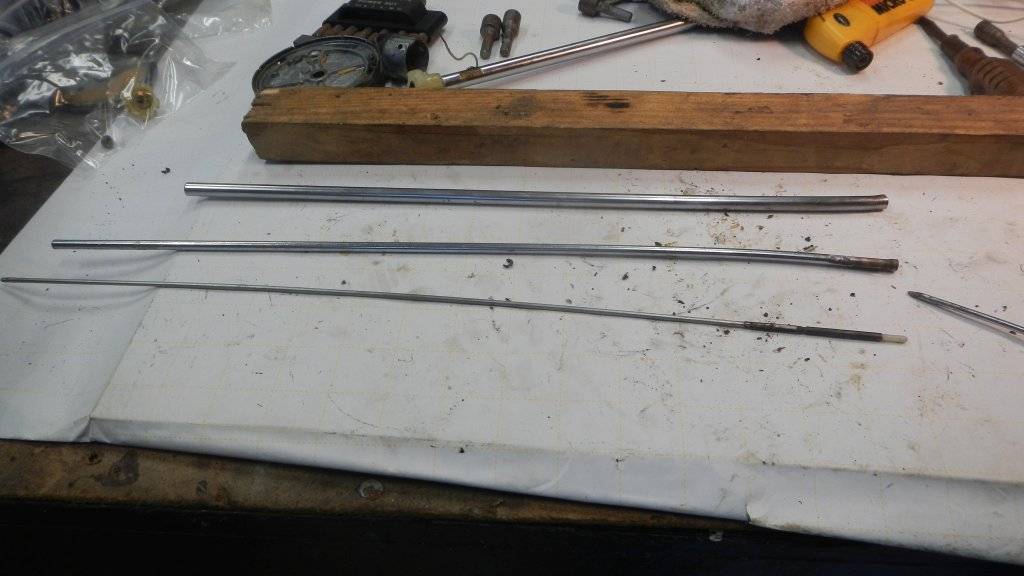

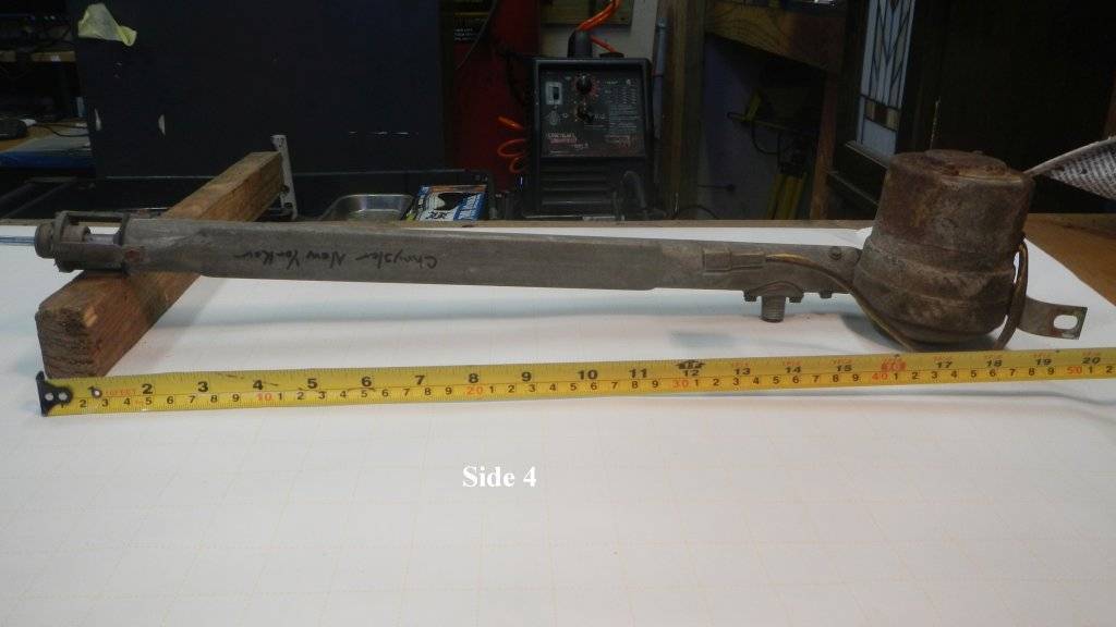

Any one I ever worked on, the nut at the top lets you replace just the mast... use the motor to drive the old cable out, and draw the new in. My guess is the cable was drawn out and the broken mast replaced, making it a manual mast. Is there a source for replacements... or did this just go back to square one?
Grrrr... I just checked with the largest supplier of replacement power antenna masts. Nobody makes one for these style units. Just the groved belt types. :(
What would Julian do...
Road salt dissolved the cable Big Join is from upstate New York they use lots.

I've seen that type of cable used somewhere else. I can't remember where right now. It will come to me.
Me too. It's a thickish white nylon. I know I took something apart and thought "this looks like power antenna cable" . :BangHead:
