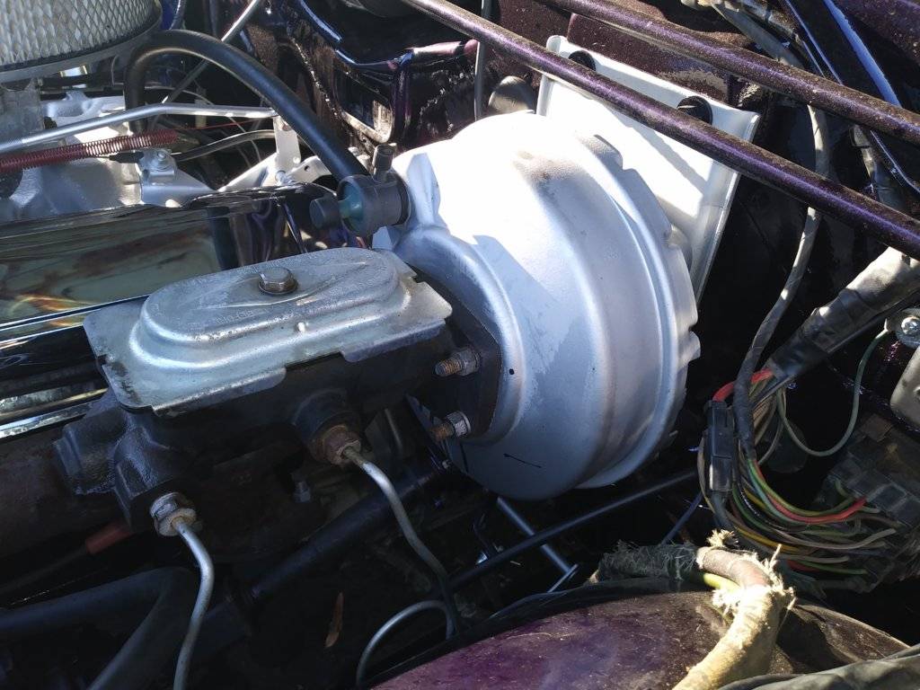

Finally replaced the rear brake line I broke when rebuilding the rear end in my 67 newport..and promptly blew a seal in my booster. Anyone know which booster I need to look for or where to find one? Sadly I just sold my extra one. Power drum. I have tried looking it up but i dont know which one I have and cant figure out the part number for it to compare.

I would just send it to:www.boosterdeweyexchange.com and have it rebuilt. Even if you find a rebuilt on thru a secondary supplier, it will likely be a cardone unit which are a POS.

This is it.

There are several on line vendors that that sell the kit, but it will cost as much as a rebuilt. That looks to be a Bendix single diaphragm unit. That is the correct link, something must be wrong someplace. Phone is 503-238-8882. Bendix boosters of this type are not considered user rebuildable. You '67 Newport probably came with a single clamp midland booster from the factory. The single diaphragm Bendix units were used on later Newports. Either would work.

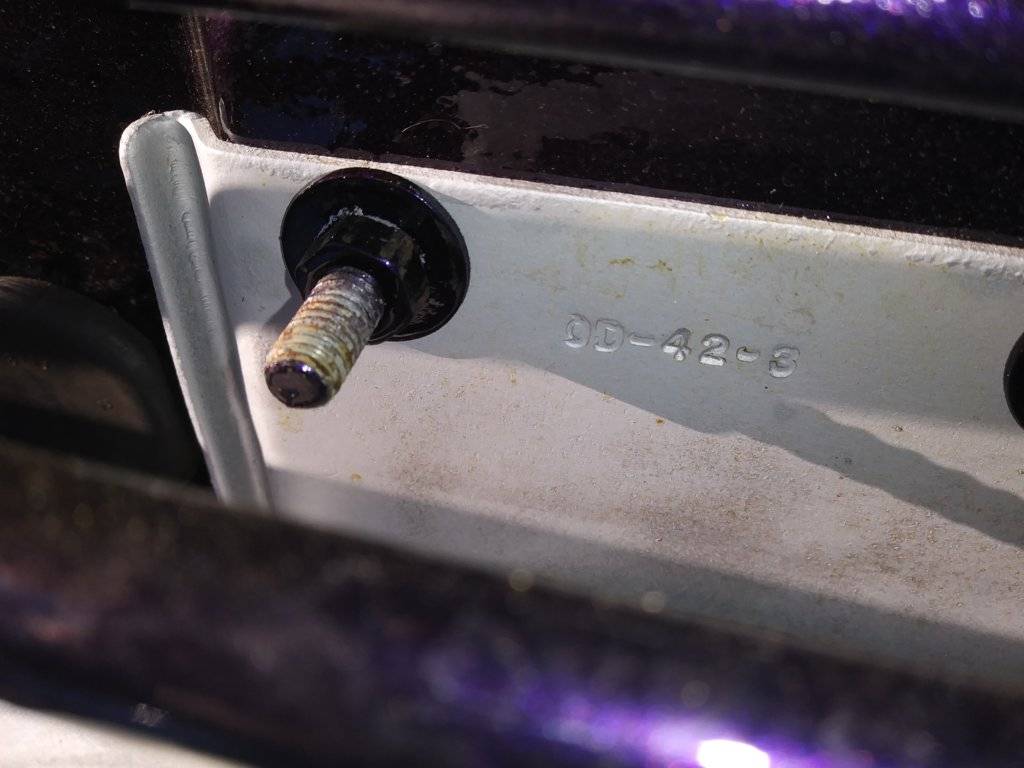

I have both digital and paper versions of the fsm...deciphering the various party numbers have me a headache trying to figure them out. Especially since mine had already been replaced and I don't know what actually came with it stock. I think I'm on the right track though..my booster had been hissing recently and then today it made a loud noise and something went very wrong inside...almost no brakes and something mechanically wrong in the pedal travel. Hard to describe it though.

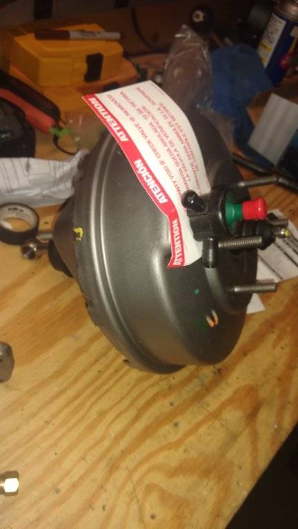

Just chiming in on this one .. your best path is to send the unit you have out to PBBE. I just got mine back from them. They do an outstanding job. I say this because I went the path you tried and wasted nearly a month trying to find a replacement, only to find that they simply don't exist anymore. I tried just about all the online vendors, Advanced Auto, Rockauto, Mopar Mall .. etc...etc. And finally ordered the same unit from NAPA that you are probably going to order...only because there was only 1 left on their system. When I got it, it was the wrong booster for my year car (65 Ply SF). It looks exactly the same as the one in your pic.
So if NAPA still has it, and it's the right one for your year car, order it. It's the LAST one. Cardone quality sucks, and that's talking personal experience. They don't reman these units anymore.

The pics are of the booster NAPA sent me...and my unit still on the car right before I sent it out to PBBE. As you can see... It's a totally different unit and that was using the correct part number for my year/model
