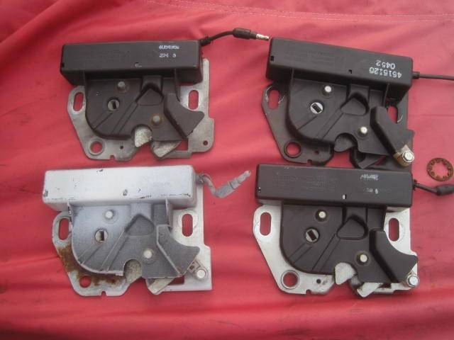

I also used an electric trunk latch from a 78 and up car. They look like this and bolt right in. You will need to use a relay for your security system. These are some that were for sale here a while ago.
