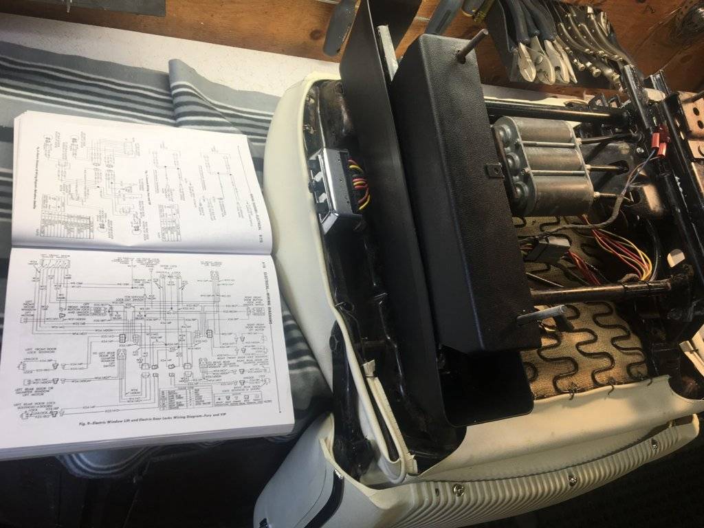

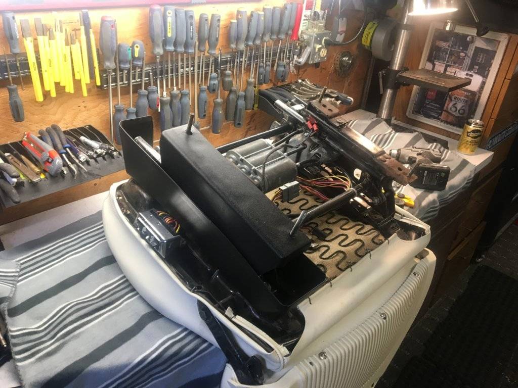

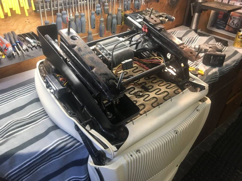

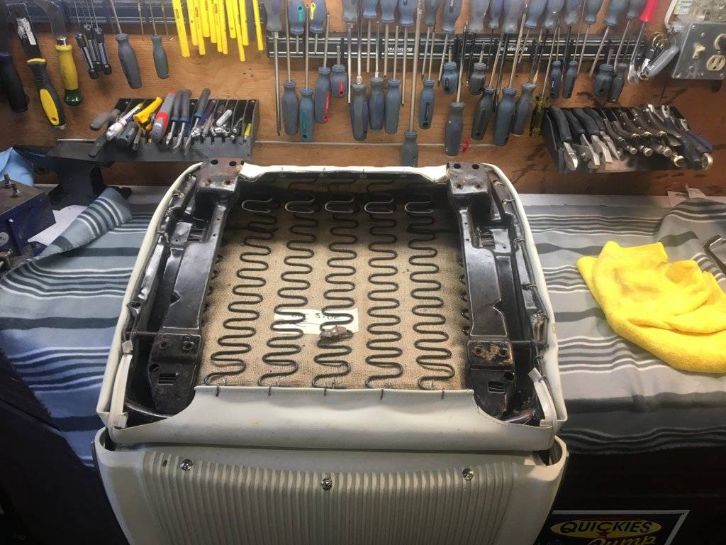

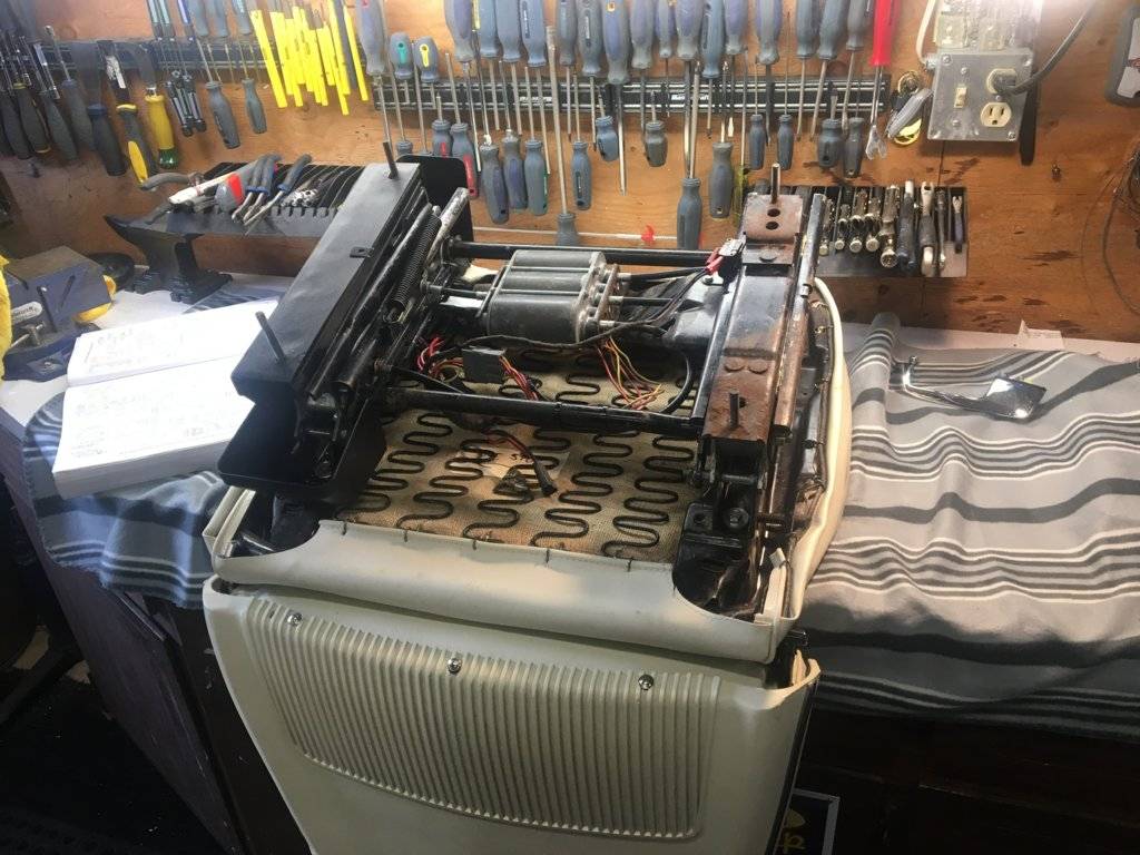

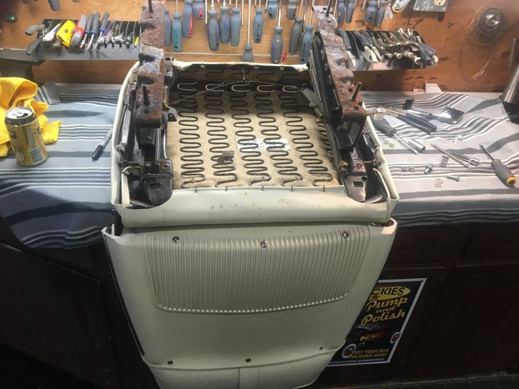

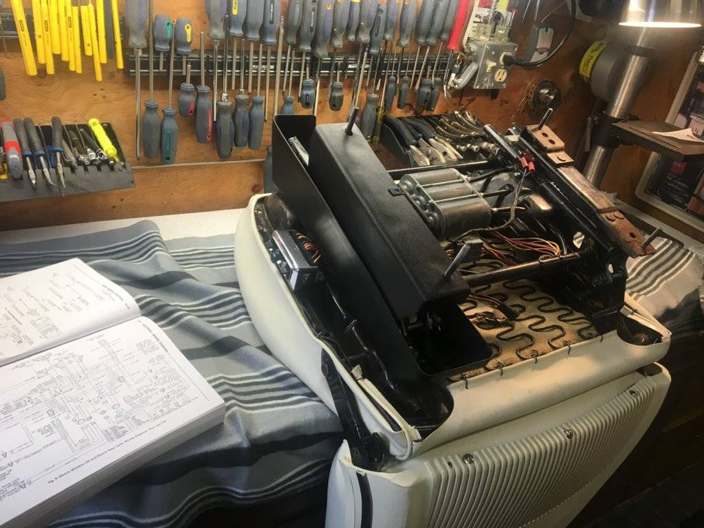

Here are a few pictures of my electric seats as I was installing them in my 69 Fury , (Maybe you can use them as a reference)The power seat running gear came out of a 71 imperial . The seats are extremely heavy!!! Get help when removing and installing if it gets to that . Good luck
That's the understatement of the last half-century.....the seats weight approximately a gazillion pounds or kilos or newtons or whatever your reference system is. They're REALLY heavy and unwieldy.
Great pics, BTW!
