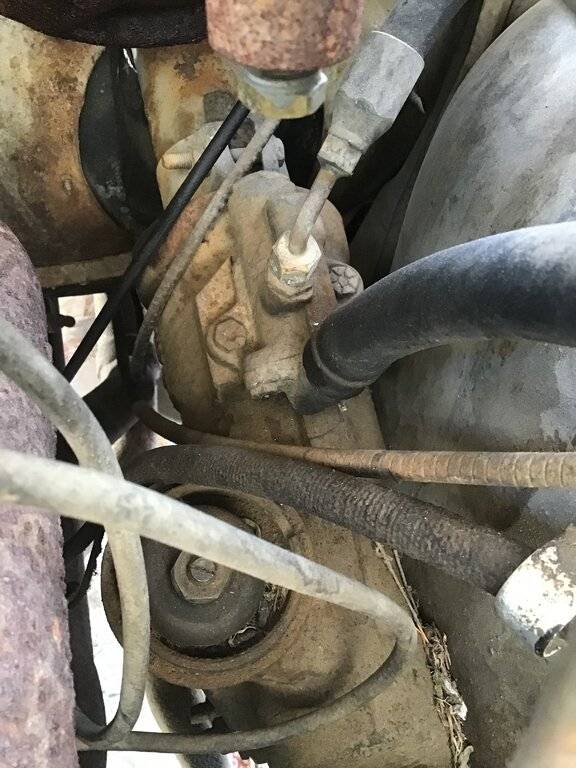

Return hose on “normal US” Chrysler /Dodge has been 11/32” diameter Power Steering hose. Originals were from Gates I believe. Make sure it says for power steering whatever brand you get.
1967 and newer was 11/32” return hose.
1958-1966 was 5/8” hose for the return. See below from a 1962.

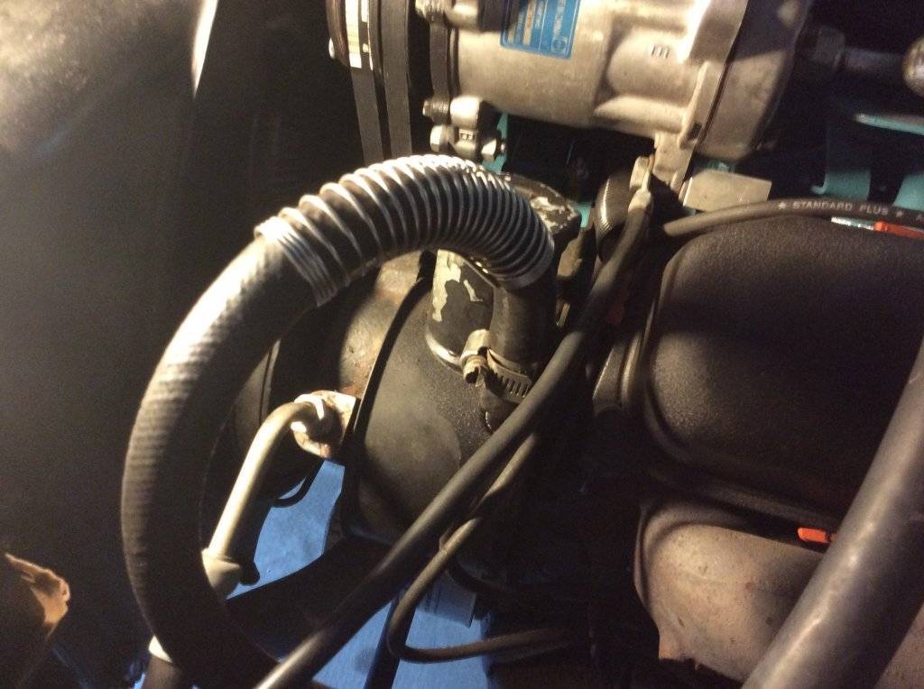

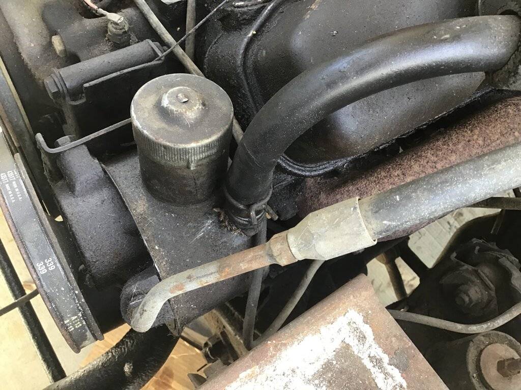

I was almost able to solve my own problem on the return hose from your pics. I cannot understand how the 5/8 hose on my 66 can be expected to be attached to a vertical up fitting, then turn 180 degrees and immediately go down to another vertical below on the gear. Your pics dont show any tight bends, which is the problem I have. How does your return hose route from the pump to the gear with no kinks please.
The factory was able to do this with one hose and no extra fittings. Try using new hose, it bends easily. An old hose is rigid and doesn’t want to bend easily. I don’t have a 1966 to look at. I’ve owned several and it didn’t look like any trick.
My photo is a 1962, the steering box is mounted behind the axle centerline where the 1965 and newer box in front of the axle centerline.
Look at the steering box photo and see how close it is to the firewall.
