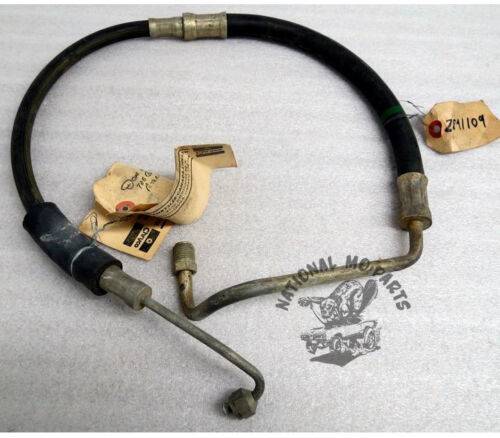

This one has been on fleaBay for eons.
Mopar NOS 1966-68 B& 67 Ply/Dodge C-Body 273/318/383 P/S Pressure Hose 2891109 | eBay
