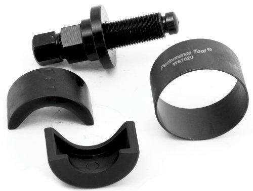

What is the best way to get the pulley off?
While some brands/tools are better than others, this is what I've used:
It's your basic removal/puller tool, just specifically for power steering pumps. You should be able to get one pretty inexpensively OR, hit up Autozone, borrow and return it for nada.
I will probably just buy the puller. I am doing the one in my Dodge truck but might need it for the Fury in the future.

You can borrow/rent one from the Auto Parts store, check it out. Good Luck
